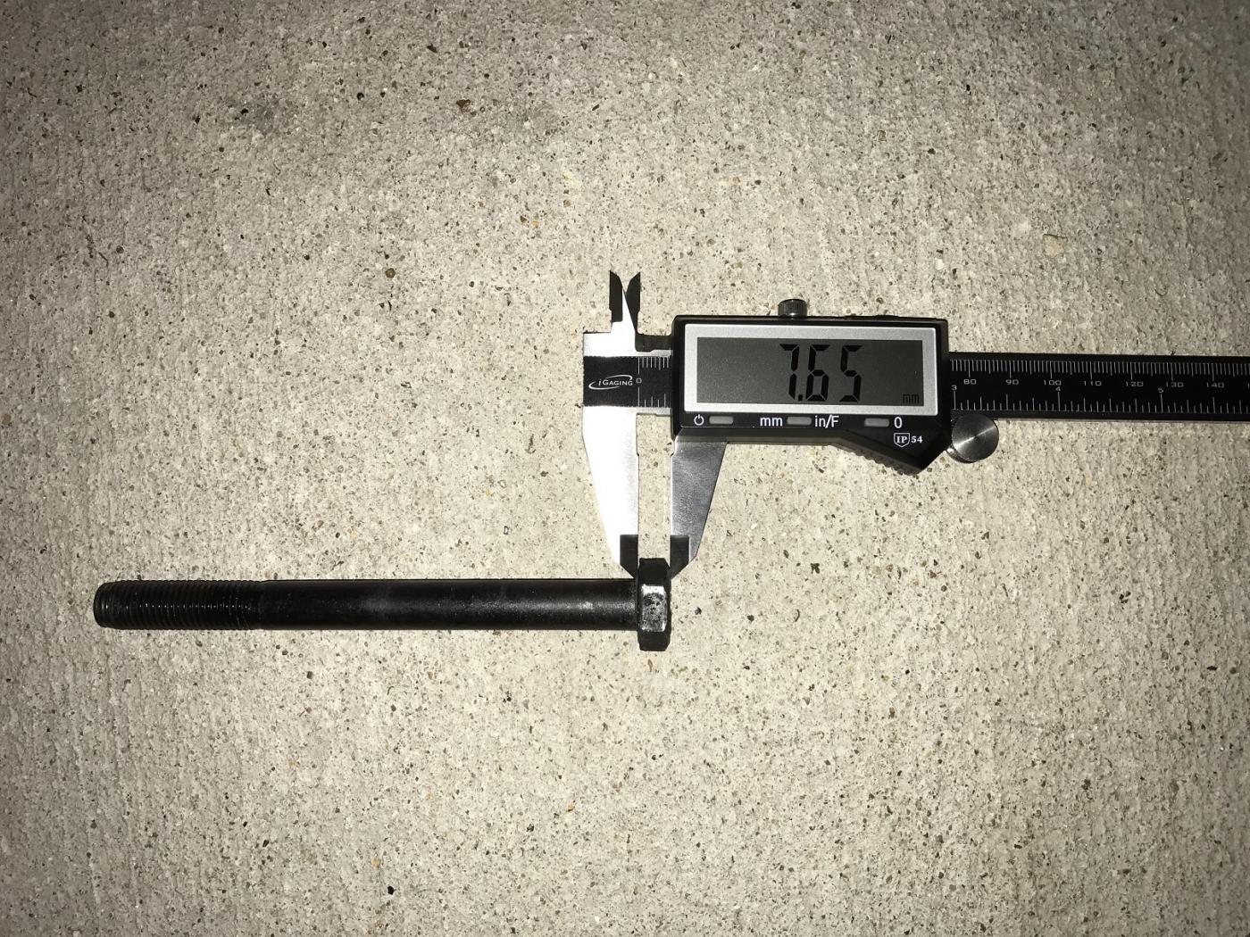

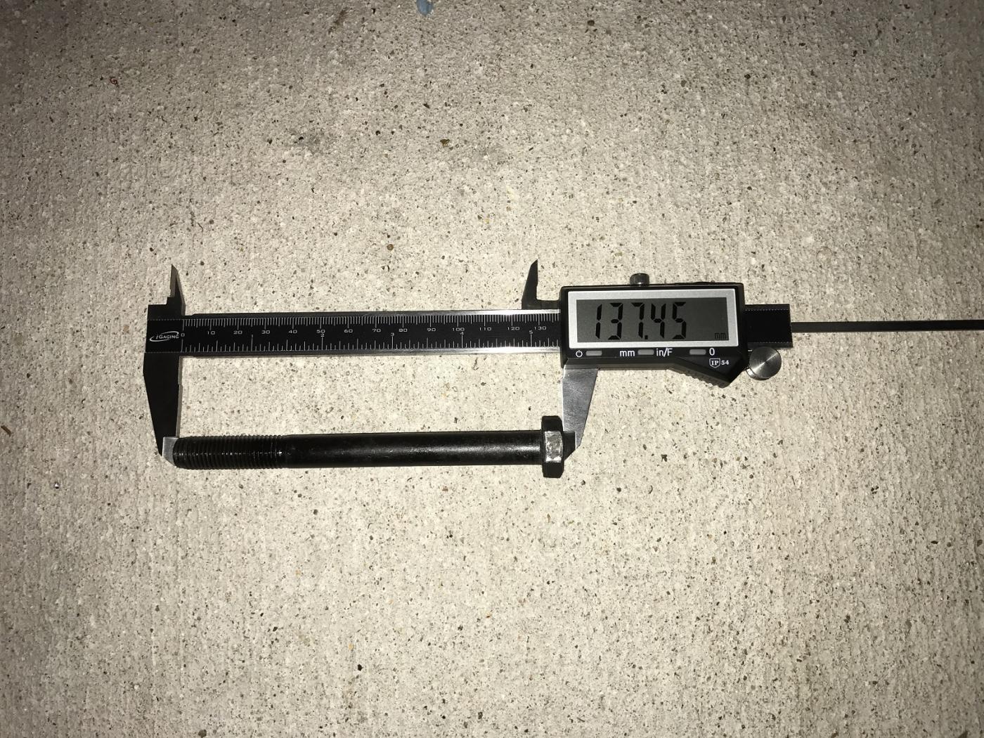

Does anyone know the size ( length) of the mMR balancer install bolt? - I need to get a bolt, but california is at least 3 days away, hoping to pick up something local - The Procharger bolt is M12-1.5 X120, assume I need something a little longer
End to end it's 5.5 inches. The bolt that is.

Have my MMR bolt sitting in the garage and took a picture. Looks to be about 137 mm long in total and 130 mm long minus the bolt head.
