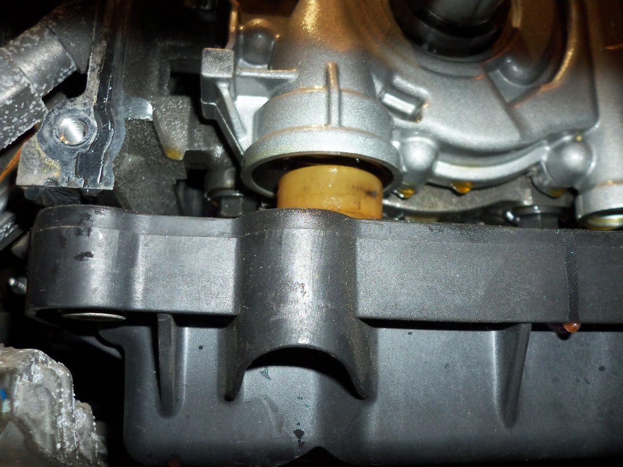

Hi guys. I thought I would share with you what I have learned from working on my 2016 GT 350. I changed my oil filter housing to the canister type and while I had the parts off of the front of the engine I read about a few more failures on this site. I decided to change the oil pump gears too. I know it's been said that you can't get the oil pump off of the crank without separating the engine from the k member but that is not true, there is enough room just by dropping the oil pan. The biggest concern I had was being very careful not to damage the oil pan gasket and getting it sealed back up afterwards. Here is a picture with the pan dropped and front cover off so you can see the pickup tube does come out of pump to allow the pump too be pulled off of the crankshaft.
