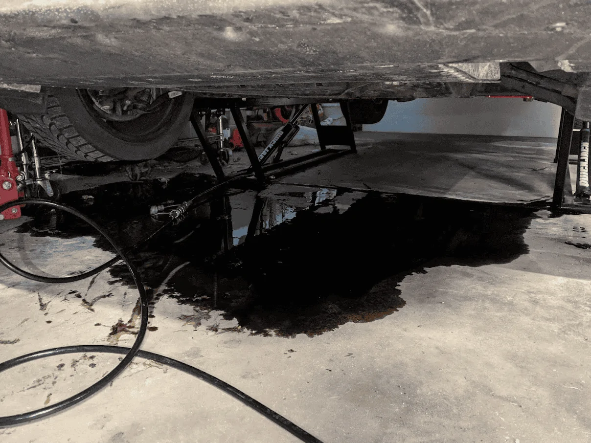

Fortunately, all the oil drained out on my garage floor a week ago (beautiful!).
Yeah, I'll clean it up well. I recall using JB Weld on a 944 Turbo block many years ago, just can't remember exactly what for. Apparently it's still holding. They make this high heat version now. I'll give it try.
