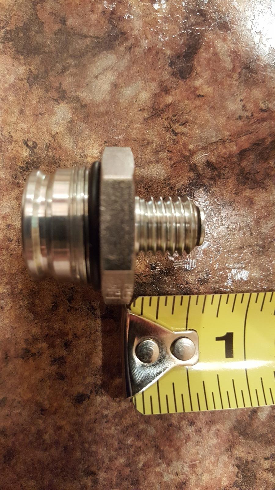

Ok so I finally got the section of this that goes into the oil pan. I originally ordered both from Jegs, got the drain part very quickly and a week later I get a notice that Jegs doesn't have the other half in stock and will ship from the manufacturer on March 9...I was like, nooooo, I need an oil change before that so asked for a rfund on that half and they refunded no questions. Had to order the the missing half (here in the pic) from Summit at $15 dollars more...at least I talked them into free shipping for a tiny part instead of 9.95. So here is the pic next to a tape measure. [MENTION=20679]HoosierDaddy[/MENTION] I hope this can work...it drains from the top of the bolt since that's where the valve opens(see the thin rubber gasket...that's where it opens so not exactly at the very top). What is not shown in the pic is the copper crush washer that would sit on the flat part. Looks to y blurry, uncalibrated eye that where it would drain is just above a half inch.

Ok so I finally got the section of this that goes into the oil pan. I originally ordered both from Jegs, got the drain part very quickly and a week later I get a notice that Jegs doesn't have the other half in stock and will ship from the manufacturer on March 9...I was like, nooooo, I need an oil change before that so asked for a rfund on that half and they refunded no questions. Had to order the the missing half (here in the pic) from Summit at $15 dollars more...at least I talked them into free shipping for a tiny part instead of 9.95. So here is the pic next to a tape measure. @HoosierDaddy I hope this can work...it drains from the top of the bolt since that's where the valve opens(see the thin rubber gasket...that's where it opens so not exactly at the very top). What is not shown in the pic is the copper crush washer that would sit on the flat part. Looks to y blurry, uncalibrated eye that where it would drain is just above a half inch.

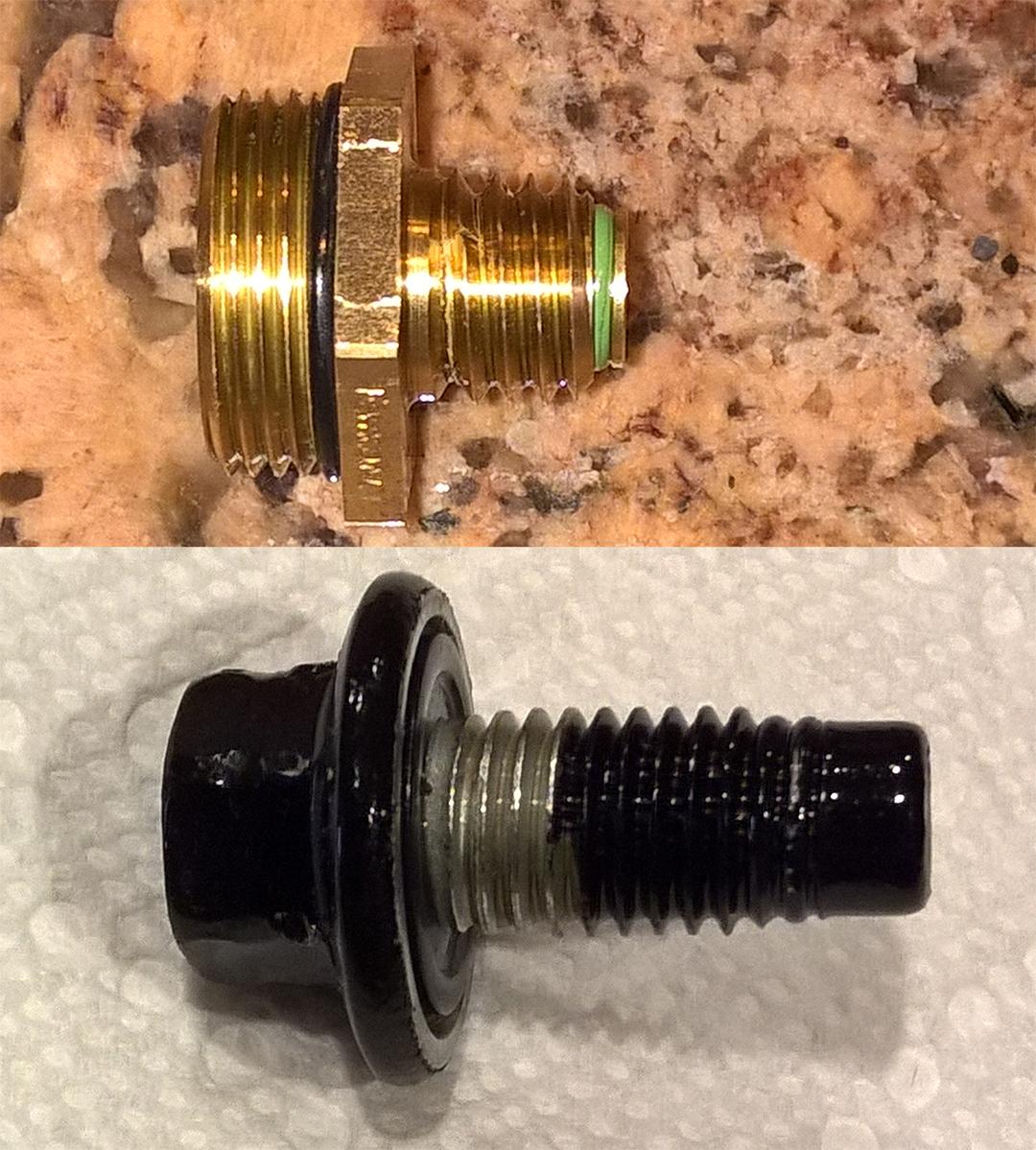

Thanks! I think that's pretty close to ideal. The pic of the Femco and factory part (see below) shows the 2015-17 pan to be 4 threads thick. The Femco is about 4.5 threads (after the thick brass washer they use but I did not show) Your pic shows 6 threads but I think there is also a gasket that you didn't show, So worst case its 1.x threads longer than perfect. I wouldn't care about that if I wanted that brand.
For anyone buying these, despite their warning of leaks if not torqued to the value they provide, I would NOT exceed the torque specs for the factory drain plug because THAT is the torque the pan is designed to take.

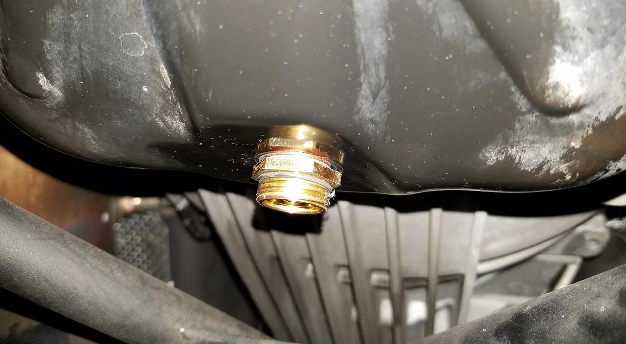

[MENTION=20679]HoosierDaddy[/MENTION] you are right about this..."Your pic shows 6 threads but I think there is also a gasket that you didn't show"...there is a metal washer/gasket. I installed this past weekend and the only issue I had was tightening down the valve. It is a huge socket that is needed...can't remember exactly which size but I did not have it in 3/8 only 1/2. My 1/2 torque wrench only goes down to 20 (accurately) so I used that and just got it tight enough by feel, never went to click. So far, zero leaks and I look everyday since my dumbass spilled some of the oil I was putting in (funnel slipped and some poured down the side of the engine bay)...all good so far :)
