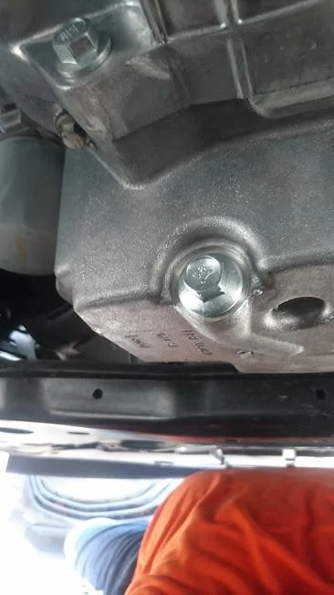

Did an oil change on the ecoboost and decided to take a picture and some measurements. A Femco valve might fit but could be tight. It is about 1.5" diameter, could somebody measure the outside diameter of the Femco that sits against the pan?

I installed a right angle Femco valve. It can be tilted down for better drainage and then swung back up out of the way. Expensive but saves me time under the Mustang.
I believe the Femco will fit. BUT since the base of the Femco is the hex you tighten it onto the pan with, you need enough enough width for the socket that goes on the Femco. A compact small base valve takes a 22mm socket to install. So grab that size socket (thin wall if you have one) and see if it fits. Based on the pic, I think it won't be a problem.
Do you mean Fumoto SX series valve? I don't think Femco makes a right angle valve and it wouldn't make sense for them to.
Fumto developed the right angle valve because of issues with the lever tower hitting obstructions while installing or the tower ending up in an inconvenient spot when tightened since its at the mercy of where the pan threads start.
The SX still extends farther from the pan than a Femco.
If you ARE talking about the Fumoto SX, I wouldn't recommend rotating it every oil change. The rotating part is supposed to be locked in place during installation. To rotate it for an oil change would involve either never tightening it or stressing the o-ring by repeated tightening with a wrench for each change.
If you are rotating it just to aim the oil flow, leave it locked in place and put a hose on the end to aim the oil flow.

It was a Fumoto SX rt angle valve.
Sorry, I am terrible at remembering similar brand names. It WAS a Fumoto SX right angle valve. I don't have a lift and got sprayed by oil the first two times I changed the oil. There is no way to slow down the outflow when unscrewing the OEM plug. With the SX, which came with a poly hose that allows me to correctly aim the oil flow into a catch pan...no oil on me or the floor.
The SX is longer but still is quite protected up against the oil pan.
