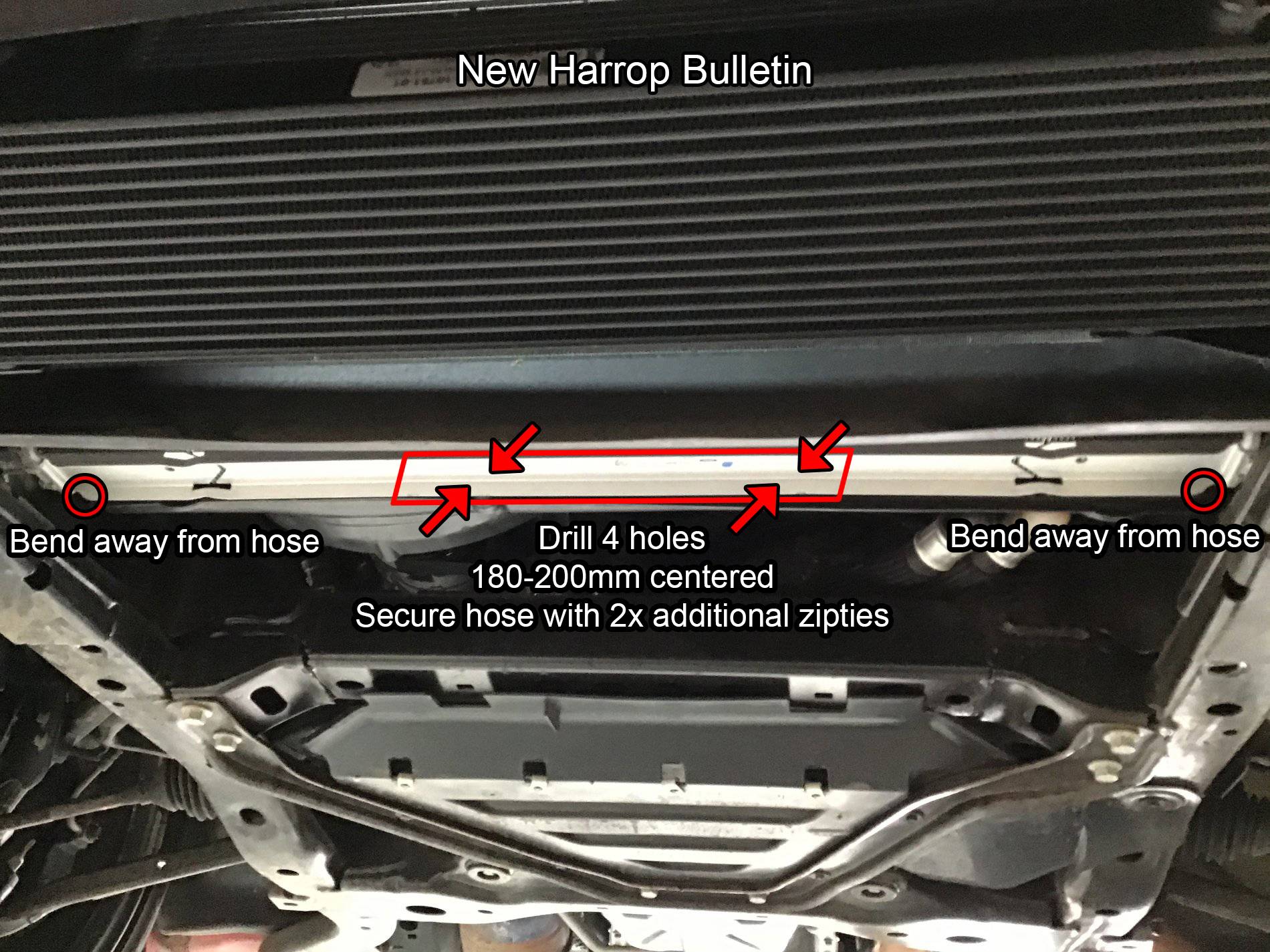

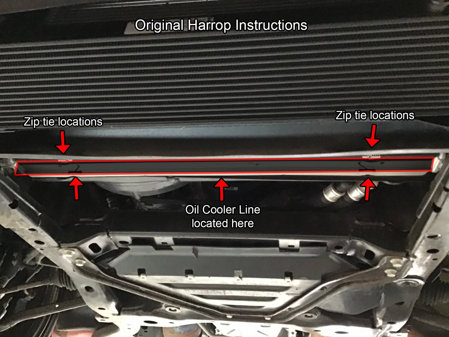

Harrop replied to my email and said they will not be covering the cost of the labour involved. They will only cover provided the oil line failed. Basically, suck it up and fix it yourself.
Here's what was instructed. The image sucks and you can't tell what is where unless you know what you're looking at or have seen the lines yourself.
I have use hackney's image and edited it to provide a better idea of what's going on. This is all under the front underbody panel or shield or whatever you want to call it, so you have to take that off and this will be what it looks like.
Hope this helps someone. Now I need to figure out what to do since I don't want to pay $100+ for something this simple, but I don't have a way to get under the car safely.

@FM GT thanks this is extremely helpful.
Oh the arrogance...it seems that in Harrop saying they will cover the cost of rectification only where there's been a failure (engine too?) they are in fact accepting liability for the issue, but in declining to foot the bill for preventative measures they're leaving themselves wide open for much larger claims. Either I'm missing something or they haven't thought this through. Also I'm not in a hurry to bend any parts of an ally radiator although it's probably fine.
It's clearly a design fault, hoses should simply not be routed across or near sharp edges.
Sorry that doesn't help you get things sorted, there's probably no way around getting someone to fix it for you although it's very poor from Harrop.
