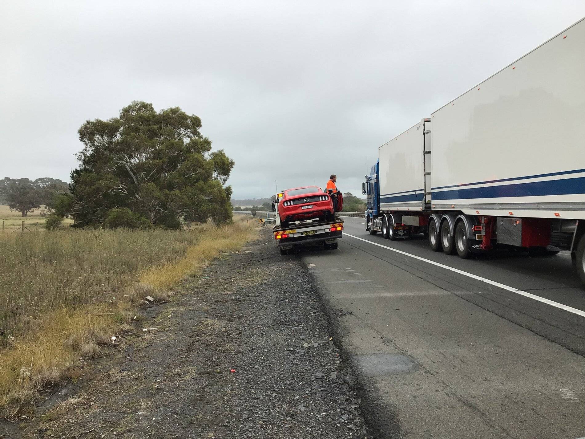

Coming back from Sydney a couple of weeks ago,noticed this funny smell in the cabin,thought it was exhaust fumes.Checked the cabin was closed off from the inside,it was.Looked out of the rear view mirror,what the? Smoke was pouring out of the exhaust,did I make a mistake & purchase a ‘diesel’ Mustang?Absoultely not!Pulled over straight away,turned the car straight away.Called up the NRMA,they sent out a truck for pick up,took the vehicle to the dealer in Goulburn.Anyhow,turned out it was a split in the Harrop oil cooler line(manufacturing fault.)Got onto Autotech in Hume A.C.T.(they originally fitted the oil cooler)Ford would not touch it,as it was not a OEM part.To their credit Autotech straight away organised a truck to come & pick it up from the dealer in Goulburn(@ no cost to yours truly.)Chris(the guy who installed it)replaced the original line which are manufactured with Teflon,replaced it with a steel braided line.This issue has nothing to do with the Harrop TSB that was issued.It was clearly a manufacturing fault with the hose.He has installed many of them.This is the second one he has repaired.Car was picked up last Thursday,& had it back on Friday arfternoon.Highly recommend Autotech,just great to deal with!
