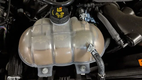

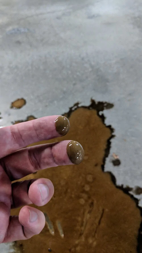

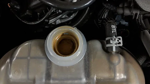

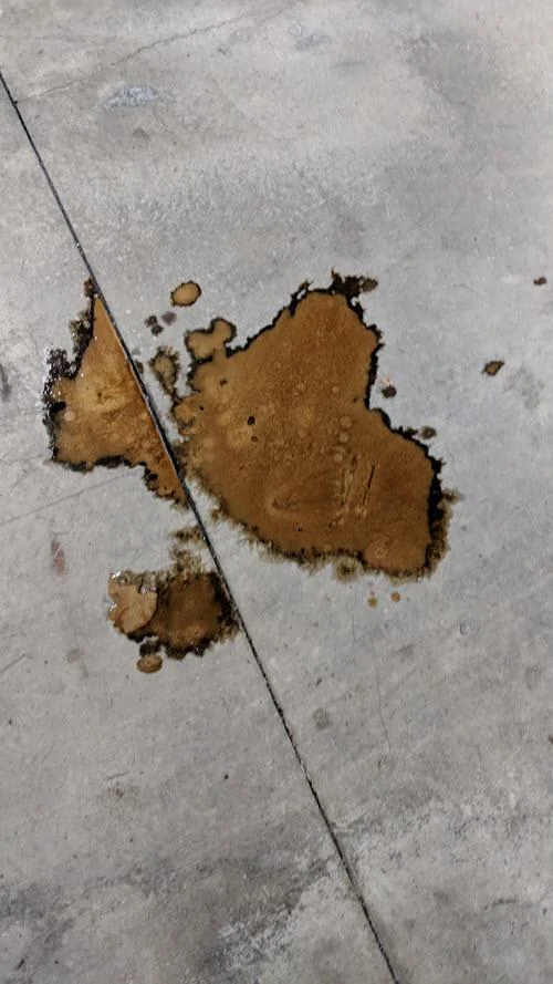

I am reliably informed that another local M6G member experienced what looks to be an oil cooler failure today.
Hopefully he'll stick his head in soon to share the tale of woe.
Yup, very reliably informed!
As Greg has pointed out, mine is a January 2017 build, with just under 9000 kms on the clock.
She had a bloody good run out from Sydney to Oberon on the weekend, a good tonk round some great country roads.
Got home Sunday and put her to bed. Went down yesterday to take her for a bath and bit of Bowdens love, and noticed a puddle under the car. Realised that puddle in no way was likely to be from the air con condensation.
Moved the car, and then popped the hood.....
Dealer was called (Sinclair's) who simply told me to call the NRMA and get her straight to them.
I am reliably informed that the car is in their Mustang mechanic's service bay as we speak. Initial chat yesterday was that is going to be a full engine replacement. I will now await that follow up call from the service team to advise!
