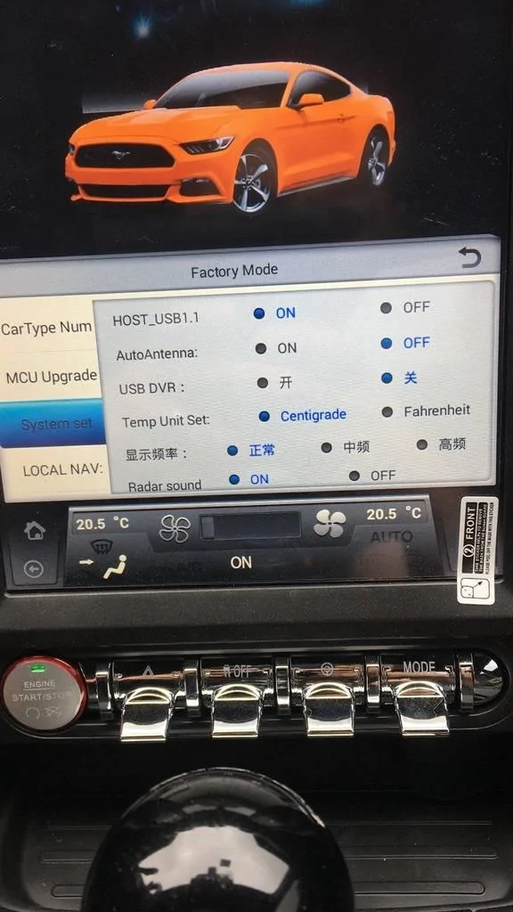

Did you get your camera work while driving? Also any way to remove the extra yellow lines on the backup camera?
Settings, System Set, Show Track the reboot. I believe turns them off.
