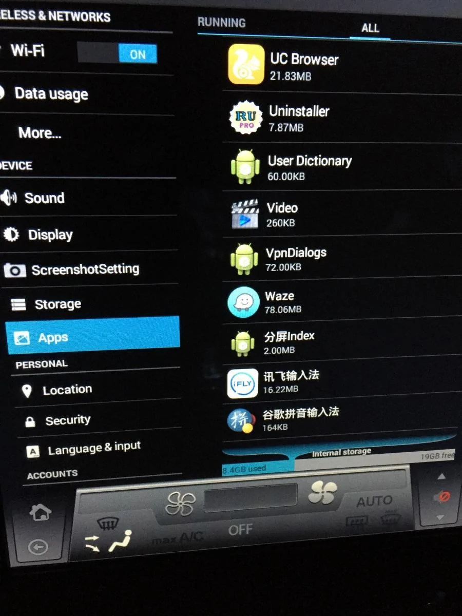

Too many people are wildly updating... I think we should pull updates and Updated APK'S until everything is stable.
Might be a good idea.
I got my unit back up by using buttons on the steering wheel swc,
The 3rd app from the bottom is what I Uninstalled, i think thats the original launcher.

Wait, what SWC . buttons did you use to restore it???
wortex
Jan 26, 2017
58
Queens, New York
Mustang GT 16
M button on the right side where volume buttons are.
It looked like unit was booted so once i pressed it, it switched to home screen and gave an error that some system app couldn't launch. After i installed s550 launcher from stang site its working OK.

Ah, okay, I thought you managed to get it into recovery. Inwas excited for a minute. Yours was booting, but couldn't run the launcher... I'm tracking now.

:) I thought I bricked my unit for sure like you did.

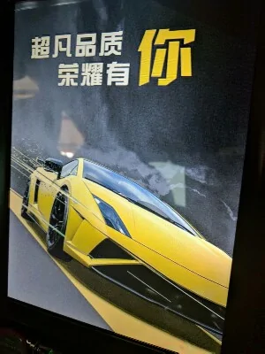

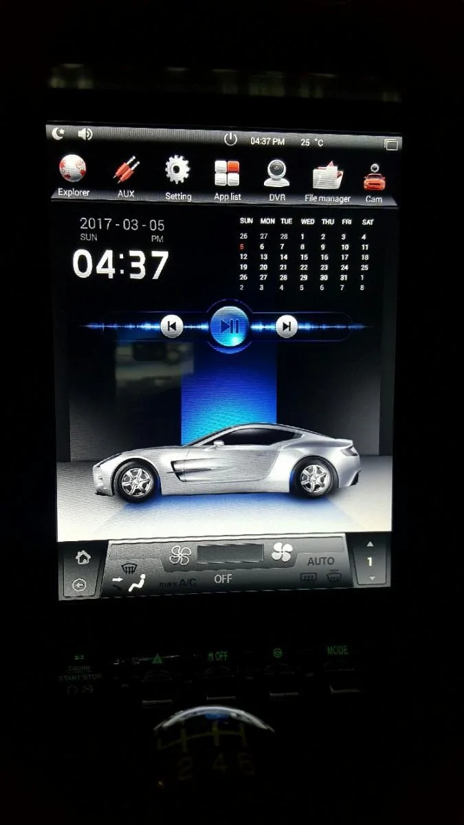

Messing around in Nova launcher, I've found a few different home screen image settings and boot screen images. Not sure what the name of the setting it was, but it was all in Chinese. The different home screen image buttons work. I posted a couple pics here. I'm wondering if the i5autohaus "vipertech" radio image is accessible through NovaLauncher. I'll mess around later when I get home, but at least there's hope of changing the orange mustang background.
