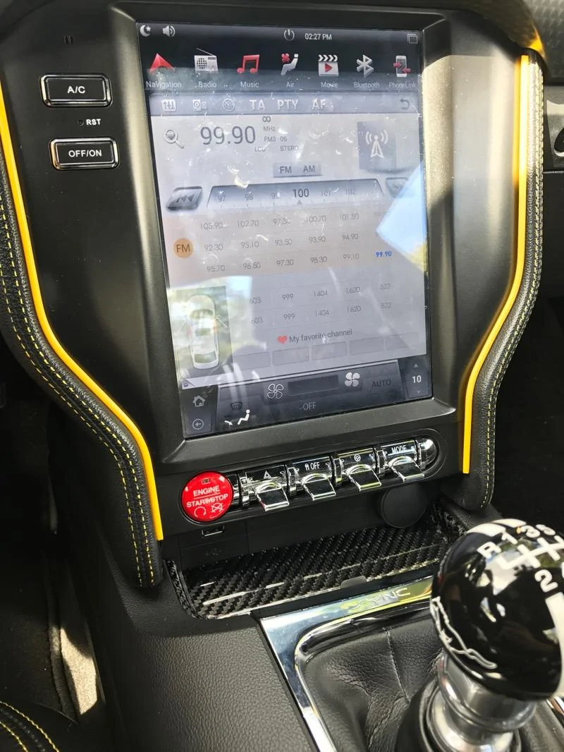

I'm going to try and do mine Saturday as well. Any big deal swapping out the start button for the GT350 button???
I don't remember if it was in this thread or the old one but I saw someone mentioning that the clips had to be ground down a bit and it wasn't as simple as just swapping it.
There are some modifications required for the GT350 button, but I don't remember who did it on theirs, but there's a post in this thread about it.
The clips dont match up at all. You will need to modify the clips on the tesla unit in order to fit the gt350 button. Youl have to shave off more than half of the clip. It does look good though when finished.
Thanks Pablo, I appreciate the info! :thumbsup:
