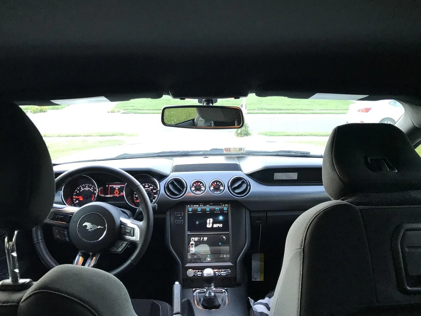

lol, looks like they're all shipping with that launcher now that we spent weeks bugging that chick with emails to try to get.Also. If I missed it. Is there somewhere to change celcius to Fahrenheit? I found where to change it to MPH. I assumed we needed to update for that.
Very interesting background though, or is that from the settings menu where you tap the version a few times?
And I don't remember 100% now, but if you go to the headunit settings (not the android settings) and it's one of the pages where it just gives you a bunch of version info with nothing to seemingly change. You either press and hold for a few seconds or tap a bunch on that writing, and it brings up a passcode screen where you put in 0987 (I think) and it takes you to a secret menu where the C to F setting is.
