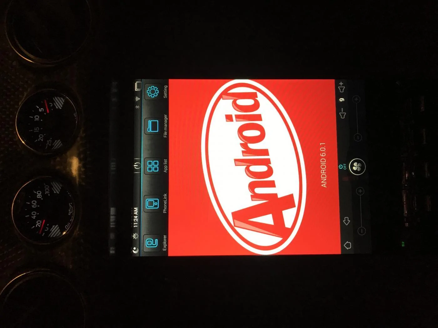

My install was successful this evening. Thanks for the info provided by you guys. My unit came with 6.01. I might just run it as is for now. It's very smooth just the units which aren't correct. I know there is an update for that. I can't find a USB stick right now so I can't really bother with it.
Not sure. This is the new Gen2 that was sent to Patrick.Interesting, have they ever come with 6.01 before?
Well shit, had I known it was Marshmallow, I would have kept it!Not sure. This is the new Gen2 that was sent to Patrick.

It's Kitkat actually. It says 6.0 but when tapping the version the K and KitKat logo comes up.Well shit, had I known it was Marshmallow, I would have kept it!
