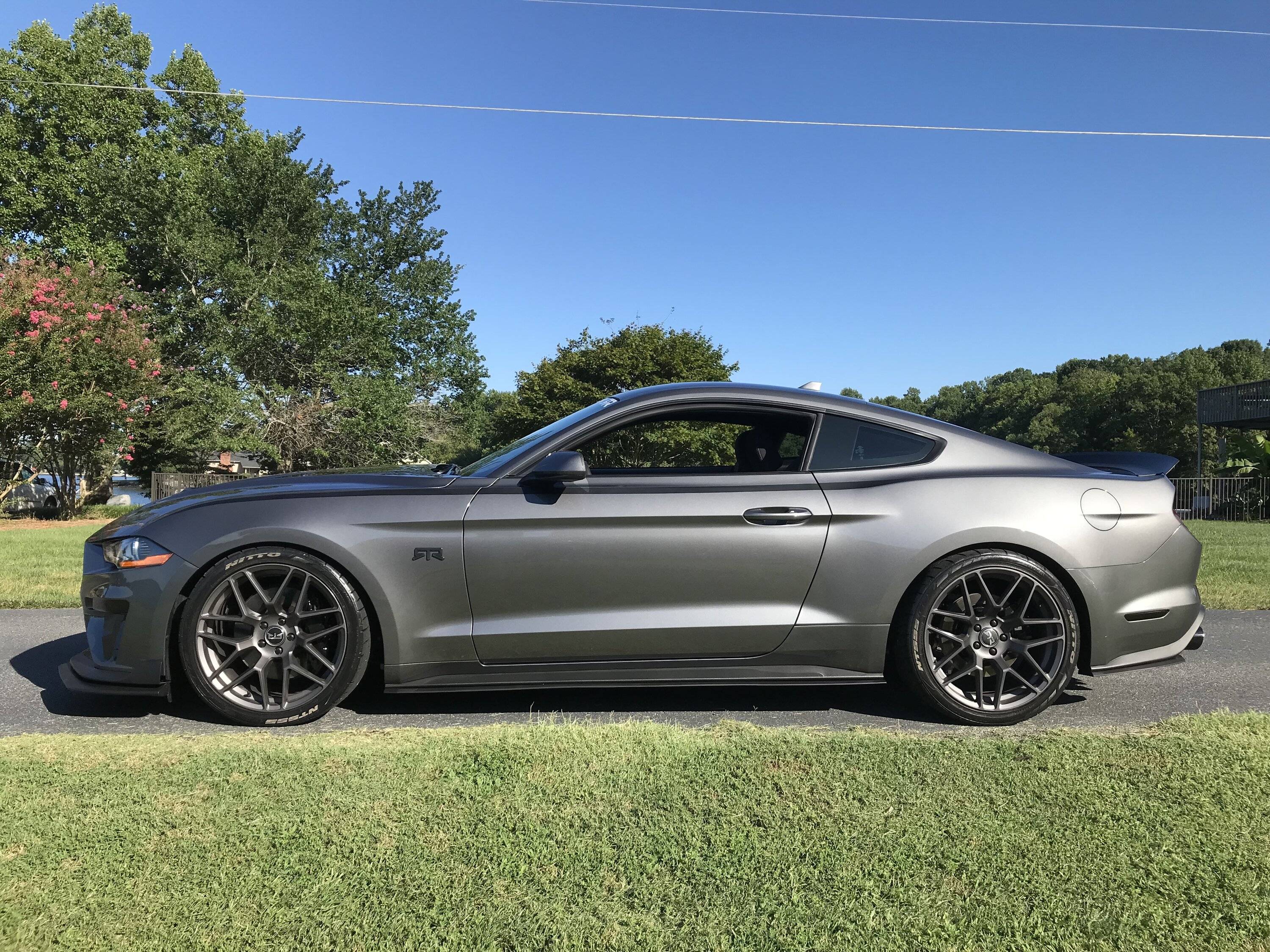

Just throwing in a pic of these wheels lowered on RTR springs. 275/30/20 all around

Will I be OK lowering on the 20" RTR staggered wheels? I was looking at the Steeda minimum drop springs (0.5"). But then I also quite liked the look of the eibach pro kit springs ~1".
@RTR077 what drop are the RTR springs you have in your pic?
Thanks.
RTR077
Aug 13, 2021
38
393
807
Denver, NC
James
2021 Mustang GT RTR Spec 1
Thanks.
That would be Front Drop - 1.1” Rear Drop - 0.8”
