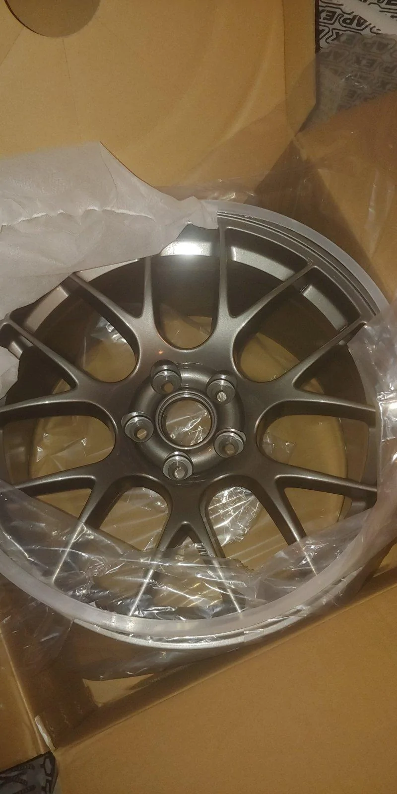

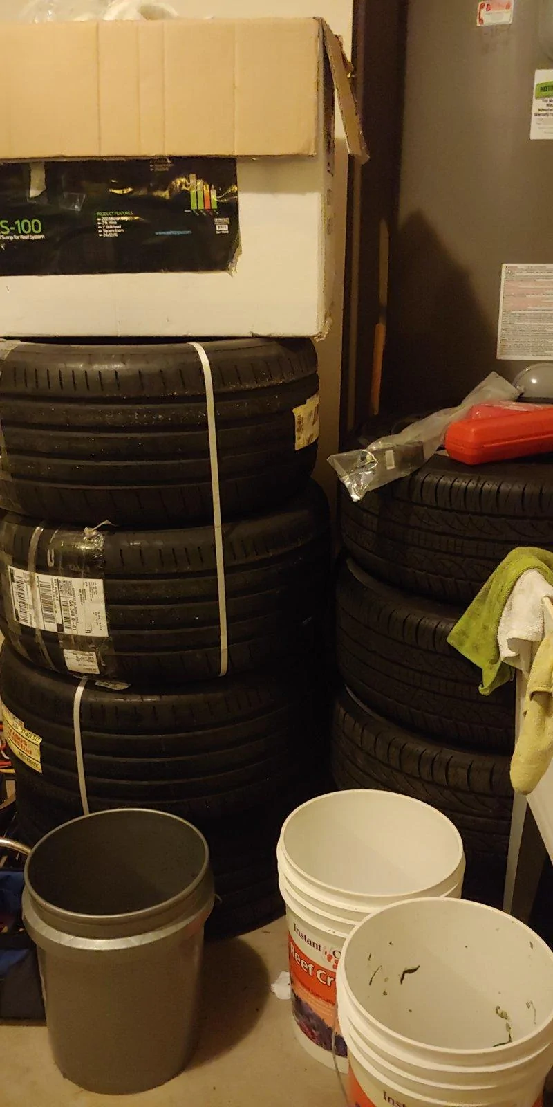

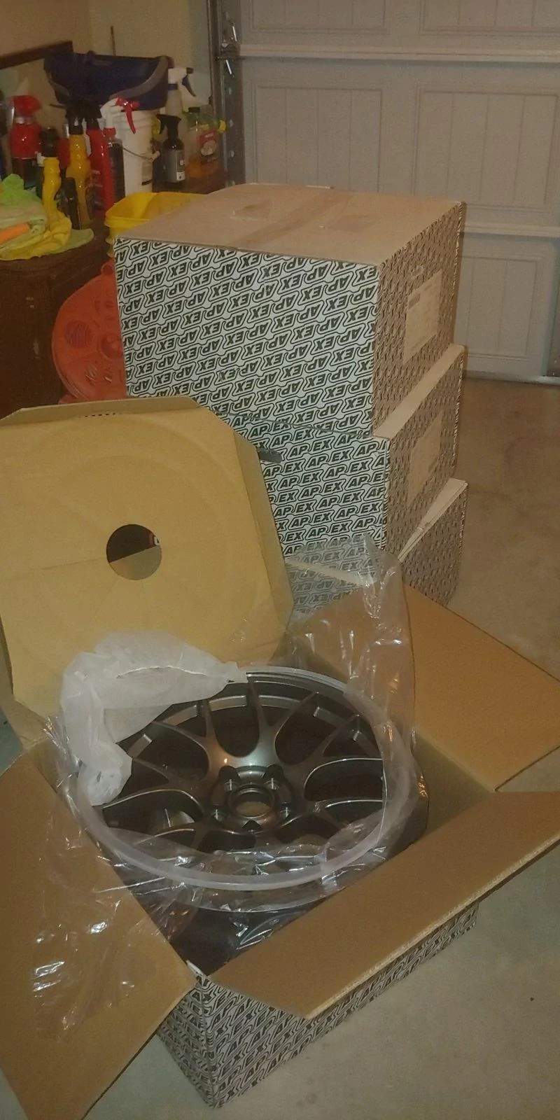

Thanks Cory.
Too cold to install on Car but I am going to try and get them mounted on the tires tomorrow.
How do you think this color will look on Royal Crimson?

I think that's going to look excellent, especially in direct sunlight where the metallic in the paint will sparkle.

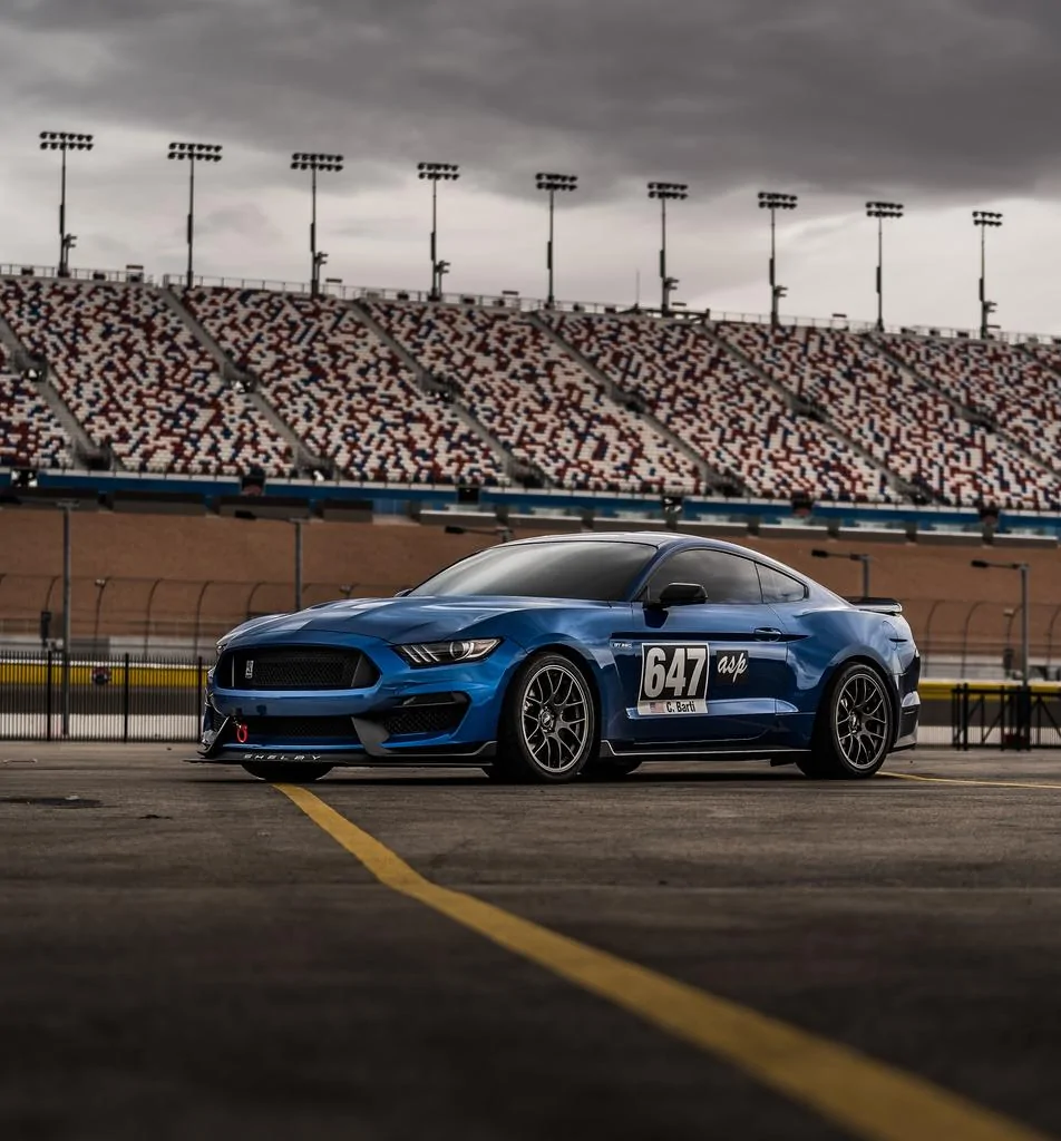

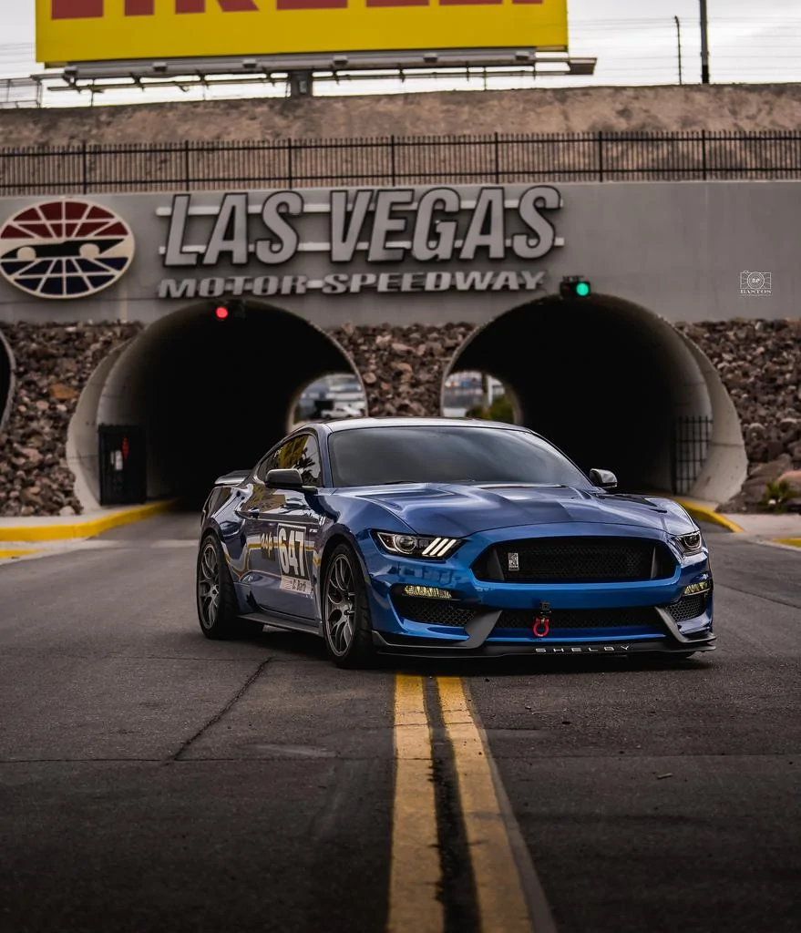

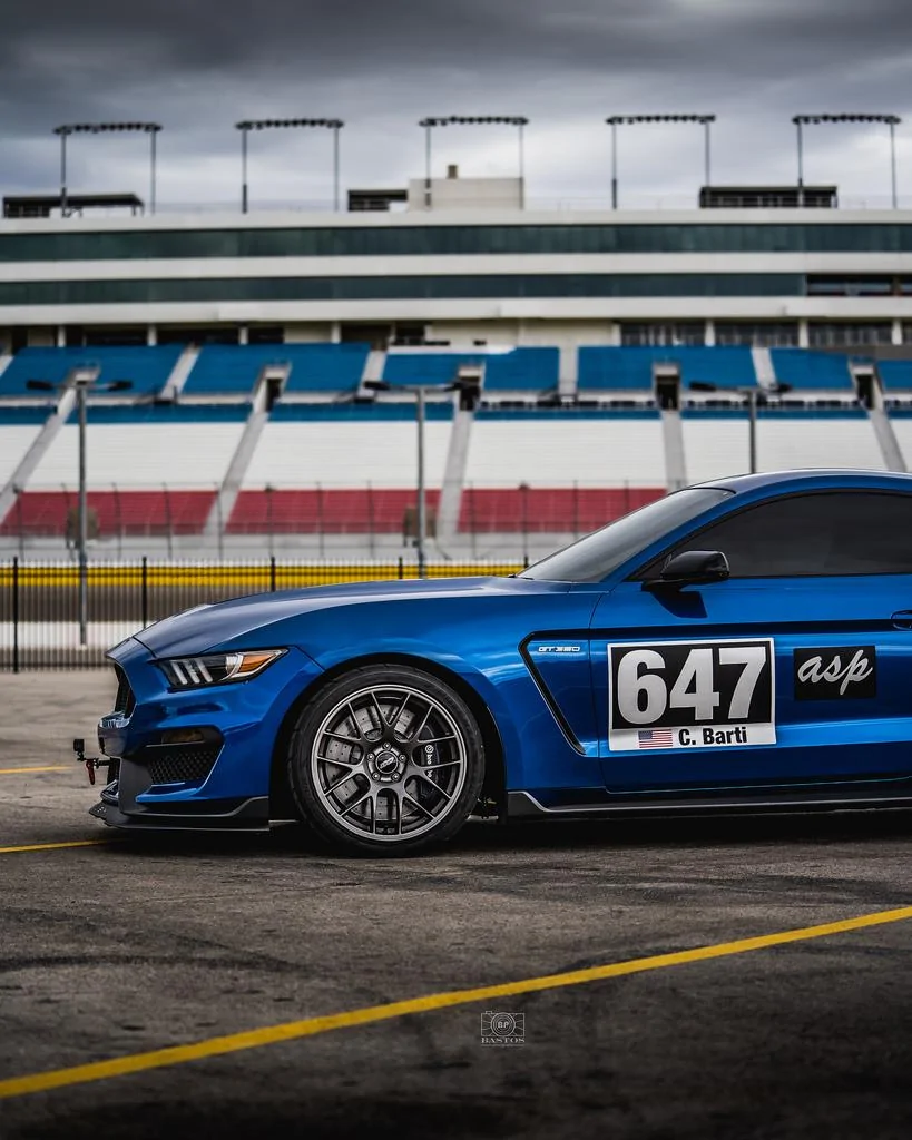

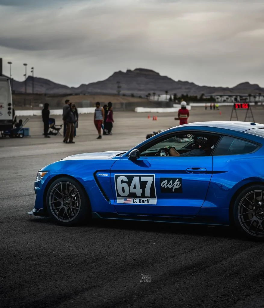

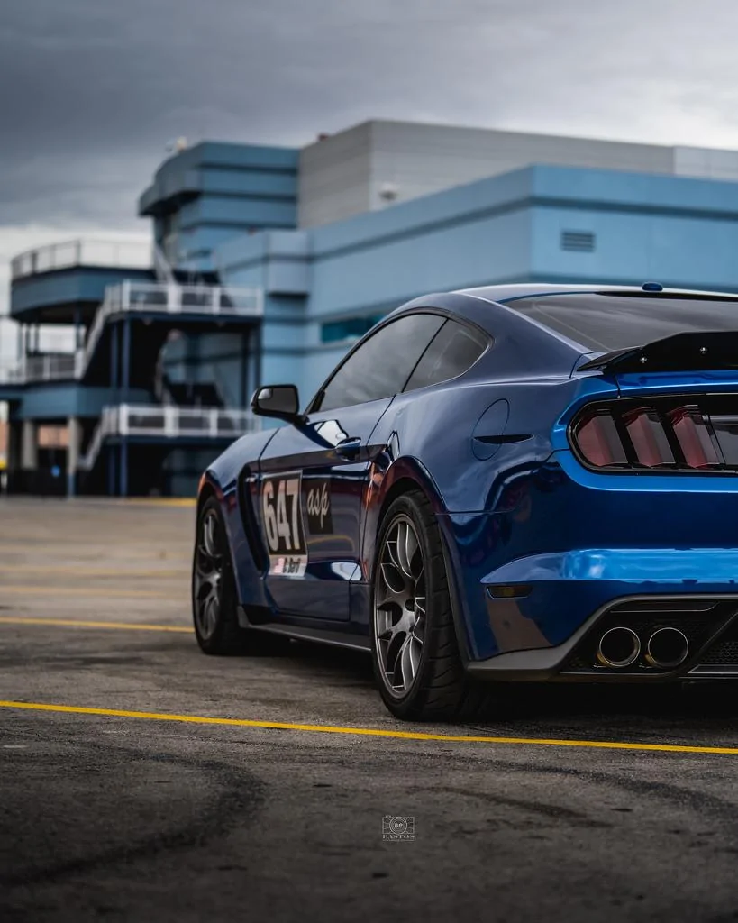

Chris got back from Las Vegas Motor Speedway and brought with him some amazing pictures. The car combined with Anthracite 19x11" EC-7s is simply stunning.
19x11" ET52 square
25mm front spacer
305/30-19 Bridgestone RE71R tires
- Cory

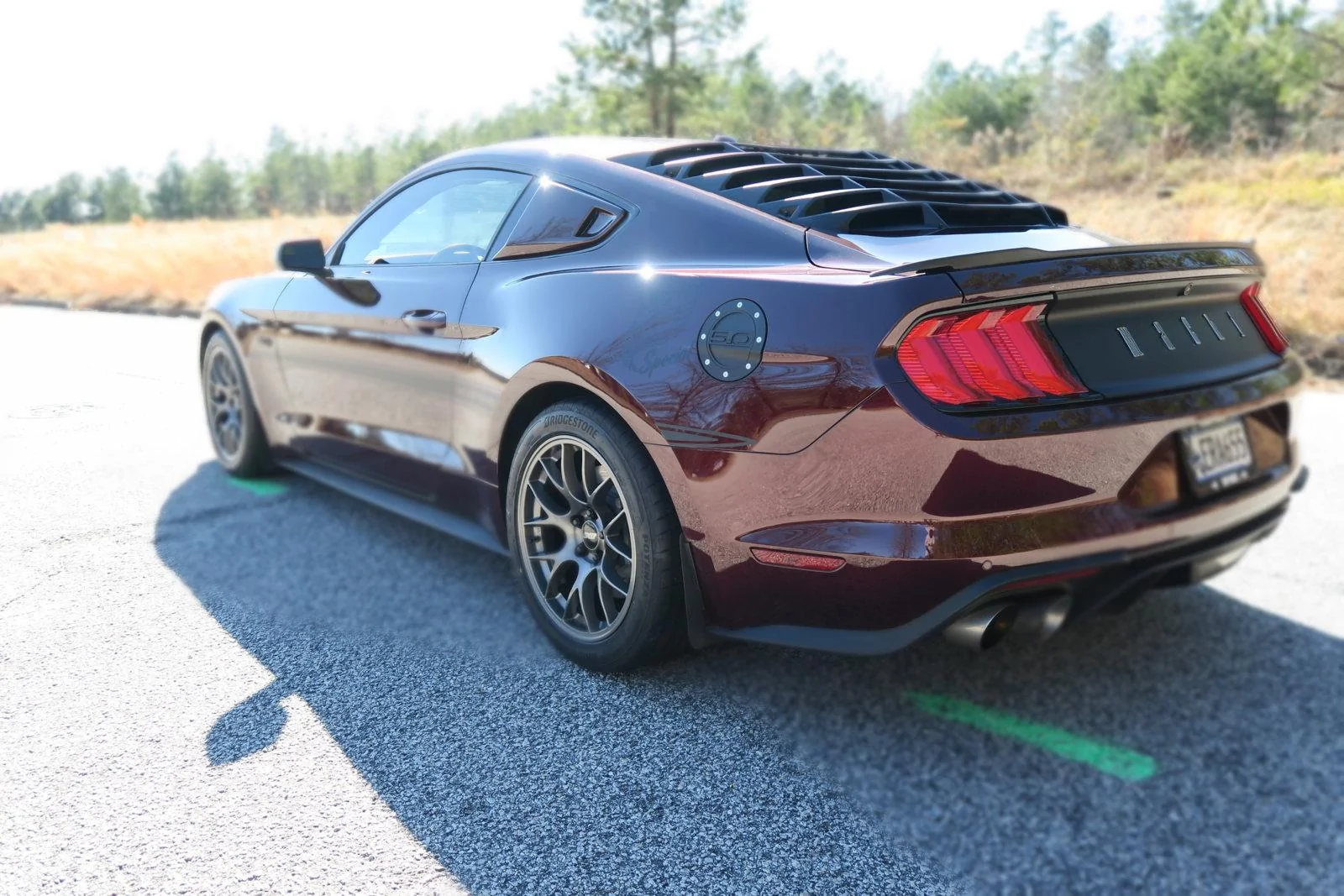

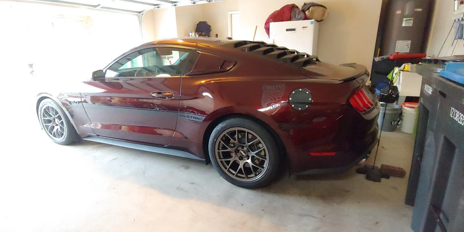

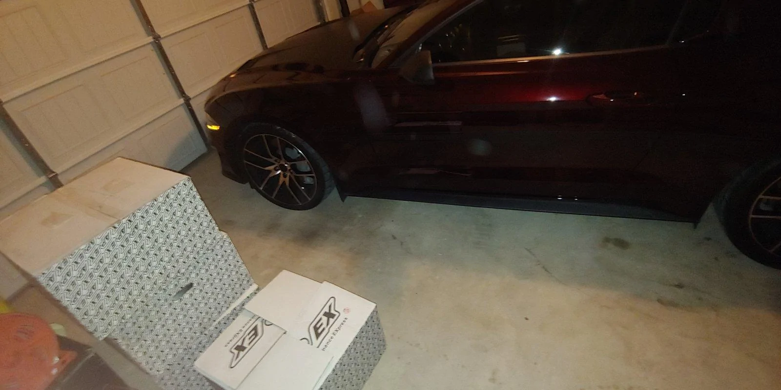

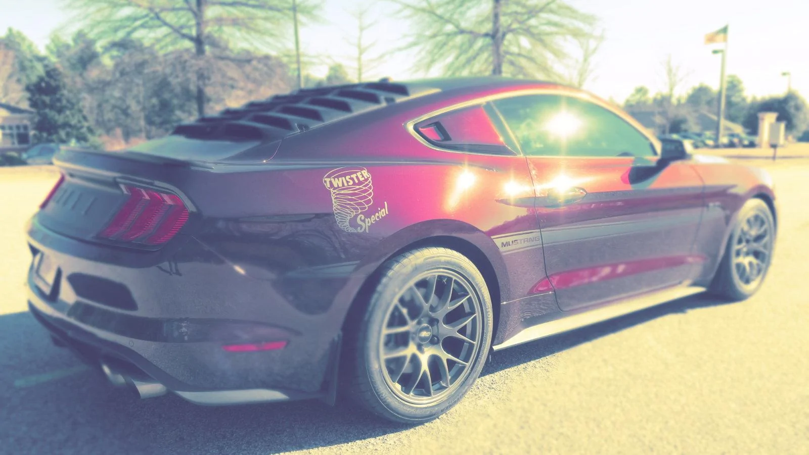

It was 64 today and low tonight is 59 . I installed them . Cell phone pics, sorry.
Make sure you use the factory style lug nuts that are either OEM or gorilla, as the aftermarket ones have a blunt end versus the beveled style. (Thanks for the tip Cory)
The ride height makes me want to rethink my choice of Springs to the ultralight extreme 2 inch drop Springs or maybe adjustable ride height coil overs.

Looking forward to more pix.

Gah if I had money I'd buy wheels from you even if they were complete poop. Gorgeous photos!
