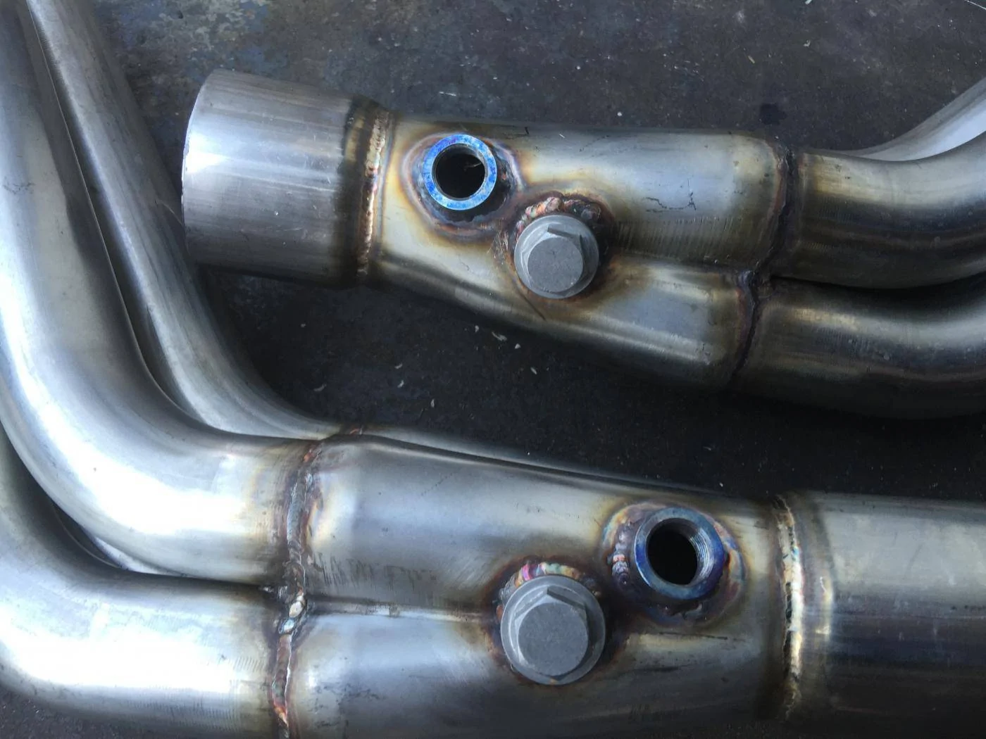

have the headers re done in order to install the sensor in a 45 degree angle instead of a 90 degree... kooks headers come like this in order to prevent damage to the sensors with e85

This actually works? How much was it? It’s a shame you spend thousands on headers and they constantly kill your O2 sensors

Yes, angling the sensor absolutely improves O2 longevity. I believe it lets the moisture from E85 drain off the 02 more effectively.
^^^ this...
that's why kooks (best brand) comes like that... it is an easy fix and your local exhaust shop can do it for like $50-$80, the issue is not the headers but the fuel... the headers are designed to work with a gas engine... when you go to E85, it's a different story... thankfully you just need an easy cheap fix

no, your headers are fine, swapping to kooks won't make any major difference... just do the sensor relocation job and you are good to go... get oem sensors. You can do it at any time at your local exhaust shop.

No, you just need to get yours redone. E-85 expels a lot of water after combustion. If your O2's are parallel to the ground, that water will lay in there and foul your sensors, repeatedly. Your sensors need to be positioned so they angle downward and any moisture build up will drain out. Any competent exhaust shop can weld in new bungs in the right location and plug your old ones. Then you can go E-85 and not worry anymore.
