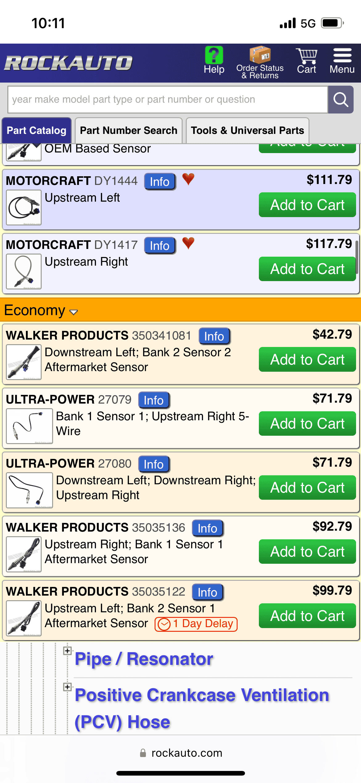

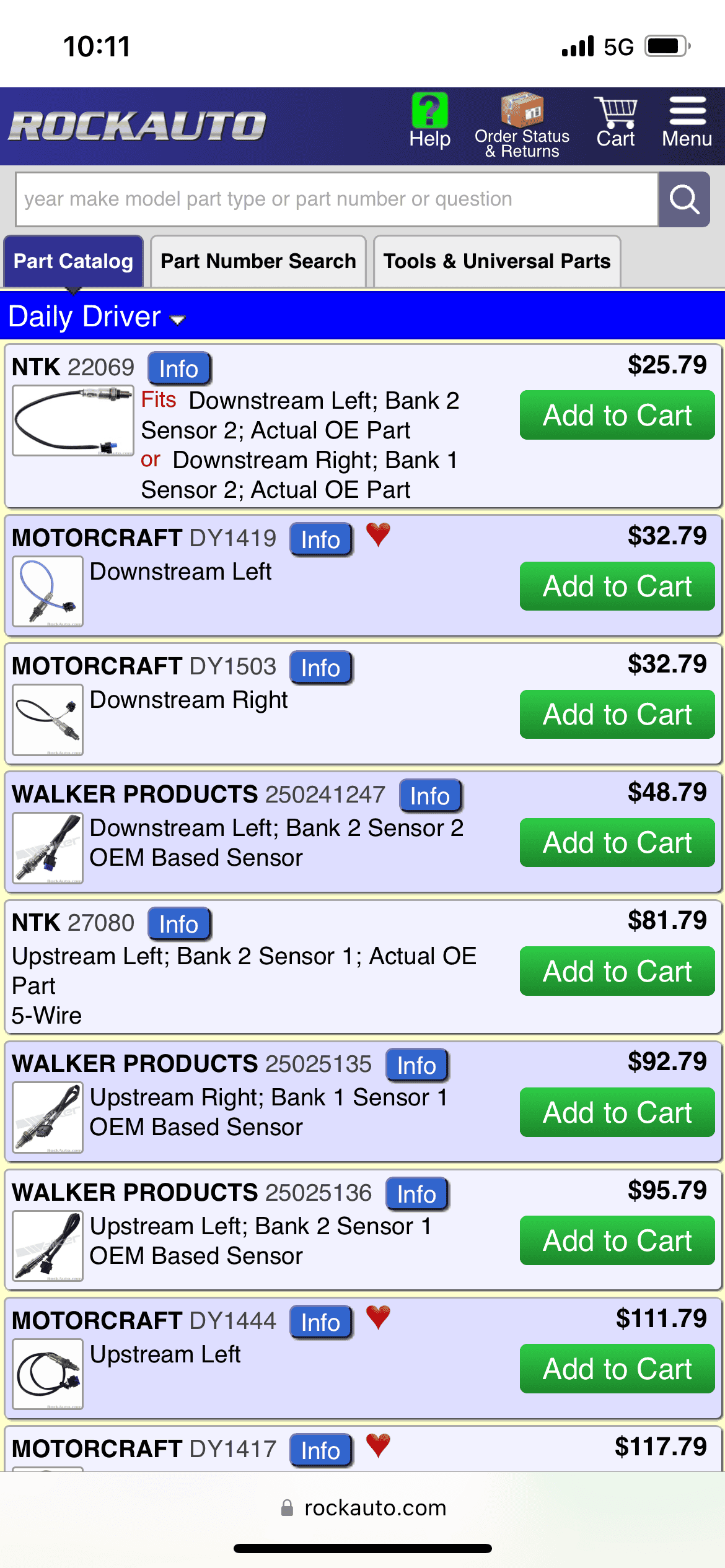

So for the f150 o2s people said to get ntk or bosch. I read somewhere here that someone tried the ntk and they didn’t reach. I have the auto and I know some said the manuals don’t need as long of harnesses. I checked on rock auto like many said on this website but wasn’t sure which was the right one. I inserted the screenshots of what I find for 2018 f 150 5.0 o2 sensors. I’d definitely go this route but wasn’t too sure about which ones to get.
Damn thats all got pricey since last year...
The best way to figure out (considering theres no cost benefit with RA) I'd buy them local to you, and check the harness length for yourself. At least then itll be easy to take them back.
I bought ngk's for my car and they were much cheaper and more availability, a year ago.
