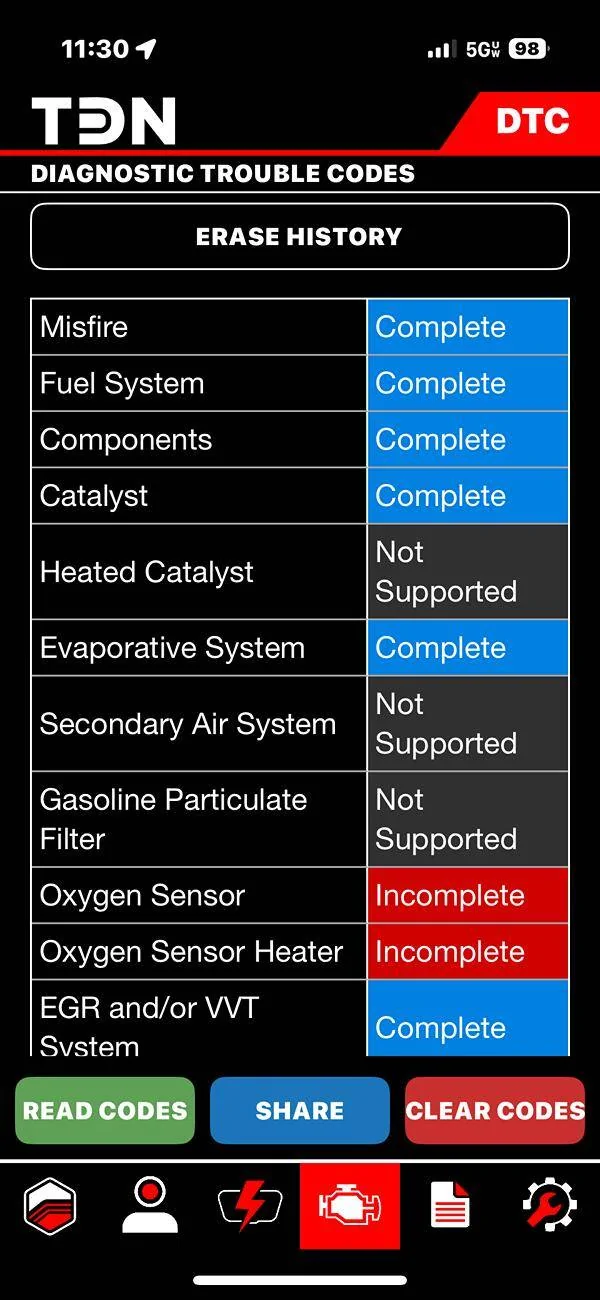

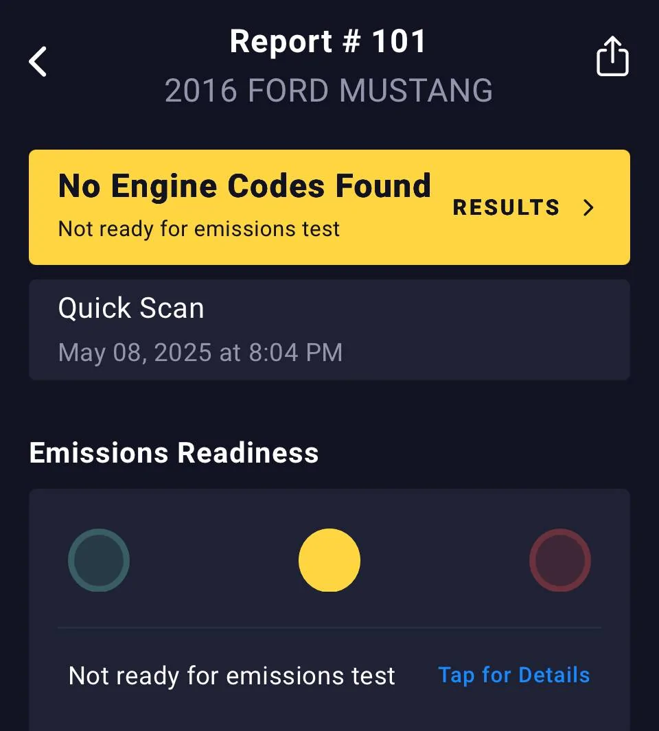

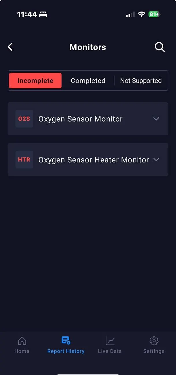

I have a 2016 6r80 GT premium and I’ve been having a hard time trying to pass for readiness for emissions in Georgia if that’s helpful. I have no cel on the dash. I’ve done a few drive cycles and still no luck. My turner stated every is stocked and my O2’s aren’t disabled. The sensors were replaced a month ago. How can I successfully pass emissions? What’s a proper cycle that’s work.

Yeah I’ve tried and failed once. Now I’m driving so do drive cycles but it seems like I’m getting nowhere.

I’d finally completed a drive cycles. This is the DTC
P2197
02 Sensor Signal Biased/Stuck Lean - Bank 2,
Sensor 1
