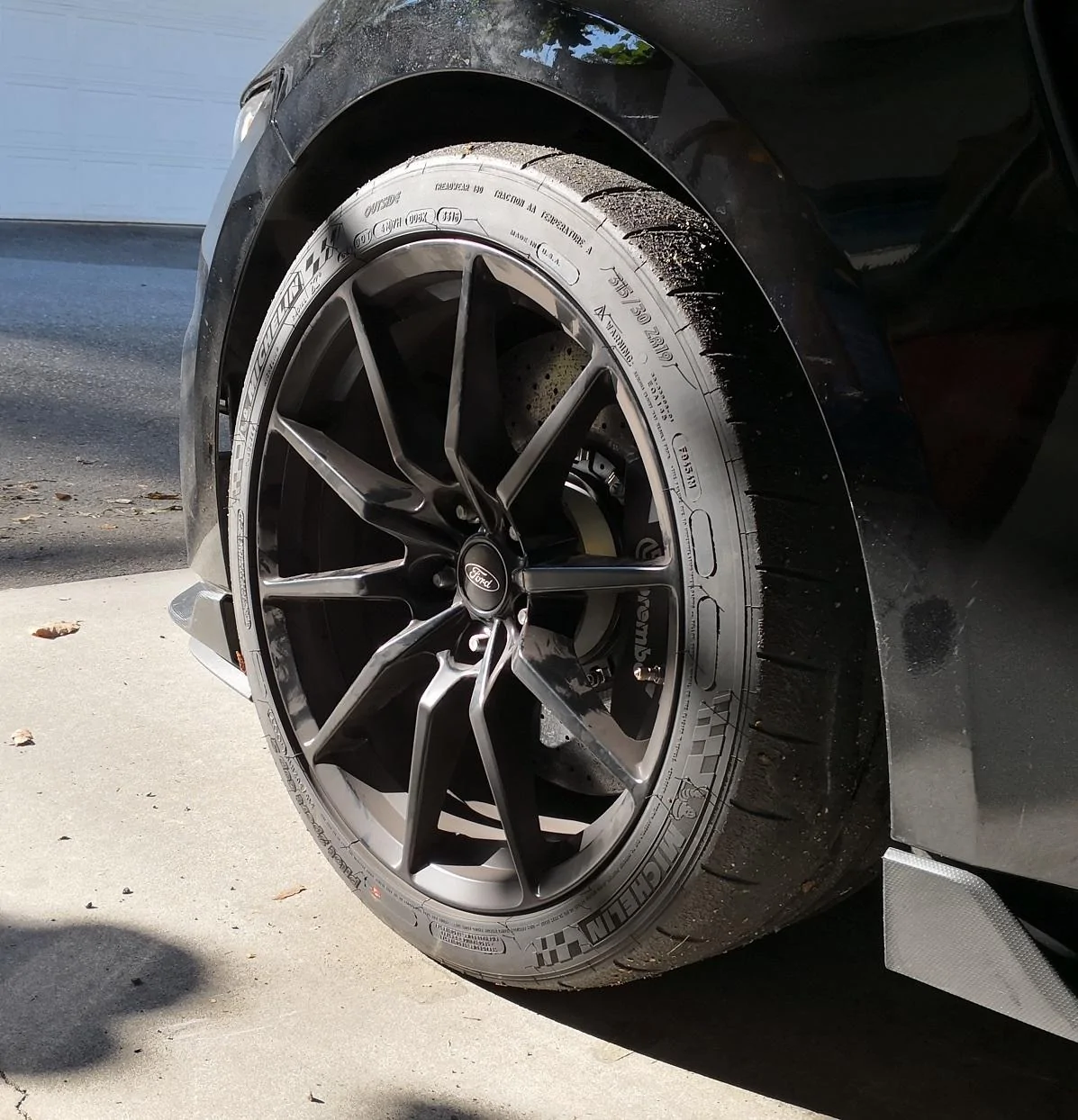

Pics of the square rear wheel/tire on your car please?
I was prepping for an upcoming event today - put the 11's back on the front. Here's an OEM 11 on a GT350R front hub with a 35mm spacer. Tire is MPSC2 in 315/30x19 (rear tire size).
