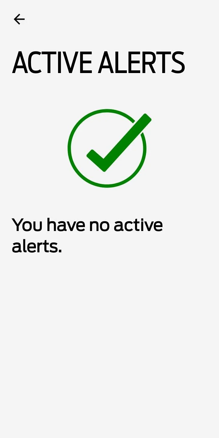

My car sat in the showroom for a long time until this sucker came along. It had to be jumped two times before my road test. And I stalled it at a light but thankfully popped the clutch out of experience as I was moving enough to fire it up. The "new" battery was junk and it was replaced that night after I paid for the car. The alerts on the app kept me informed as to what was done and when with respect to the battery.
As soon as I got the car out of storage, it got the tender pigtail installed. It may go a few days without being on the tender but when I take it out for a ride it is never to the store and back. If it is not at least an hour trip one way I make sure to find the circuitious route to put some miles on the car.
Not sure if the alerts are even on the app any more.
