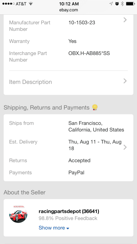

o2 extenders are roughly 30.00 on flebay. Figured I'd add that since they are priced pretty cheap for a sealed connection.

I know, 500.00 shipped for a set is crazy. That's what got me bringing this thread to the top. May as well do the resonators. The catted version is 600.00 shipped.
