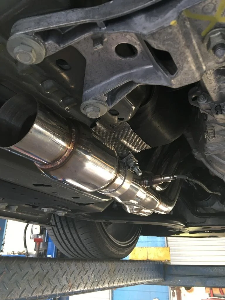

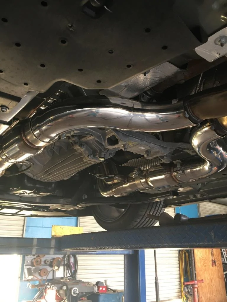

Where did you get them? Ebay? Trying to get something not that expensive for my car and at $620 they look pretty good. Thanks in advance sir.
eBay. $620 shipped including the resonators and lead pipes is a steal. Next closest is pypes at $900 for their headers with off-road lead pipes and I had pypes (also made overseas) and these appear to be higher quality overall (thicker stainless tubes with larger collector and a merge spike. These are welded mostly on the outside which means the bores are free of weld slag like the pypes had.

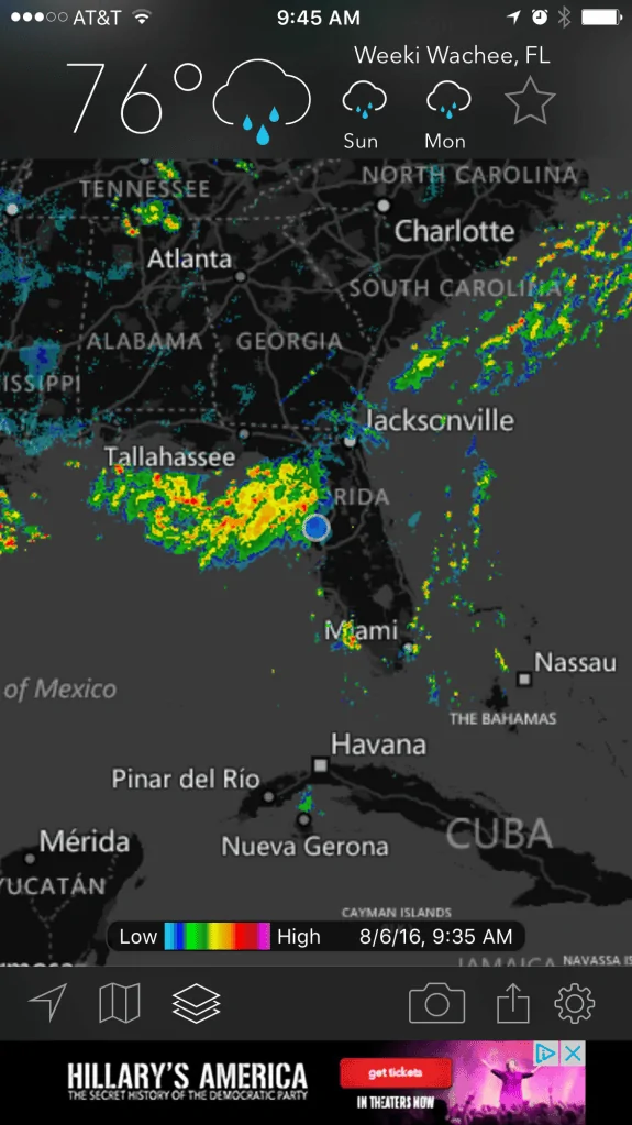

Ugh it's raining again. :( I hope the roads dry so I can do a drive by video.

It keeps raining here lol. I want to do a little fly by at wide open throttle but not happening until the roads dry. Got more raining coming any minute too lol.

They sound good and they fit really well. You will be pleased just make sure you have a 3" catback you are connecting these to because they are a 3" performance connect. If not you will have to neck the mid pipes down or weld them to your catback like I did.
