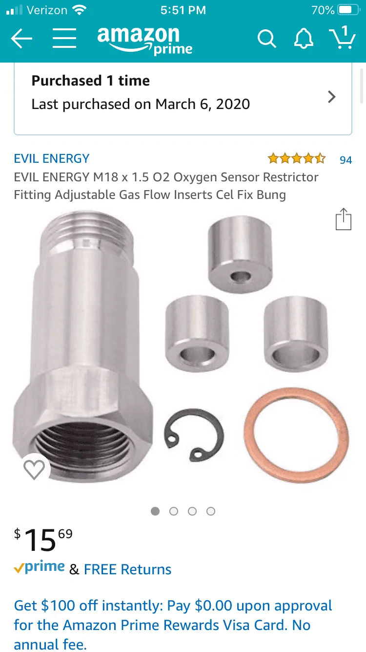

I had a tune where the 02 sensors would never get ready state no matter what, and it was the tuner not wanting to write a tune that could do that. Have you communicated with your tuner and ensured that it should go ready eventually?
What exact spacers do you have? Some have interchangeable pieces and you usually have to swap sizes depending on the vehicle or setup to make it pass.
Is that the only thing not ready? How long has it been in not ready, like a few days or just today? I think for some of those monitors to reset, you have to let the car sit overnight and do a cold start.
And just in case, do not reset any check engine codes. It will flip them all to not ready

stangyota
stangyota
Sep 17, 2023
50
46
usa
steve
2020 mustang gt
great input everyone. tuner sent me an emissions tune. so curently instaled a performance tune whice i will have to drive 100 miles to hopefuly set all monitors to ready. when tuning a car it will set all monitors to not ready, its like disconnecting the battery, as for the spacers i have, i tried non foulers baught at auto parts store, did not work. Ordered 90 degree spacers and usued parts of the spacers, that did work, no cel, no codes. the 90 degree would not fit due to the trans mounting braket. so now it is a drive and see if the monitors will become ready. purchased autolink al329 whiche will indicate emissions readiness.
