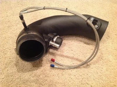

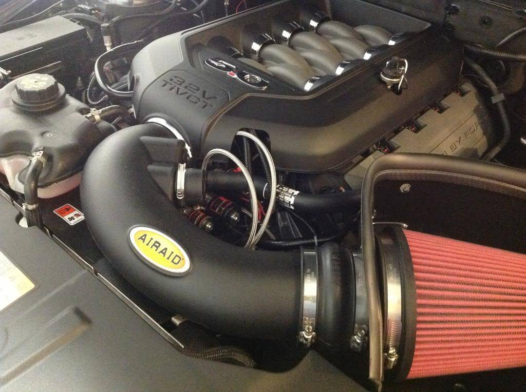

Here’s an example of how/where I installed my nozzle in the CAI pipe on my 2013 GT.
