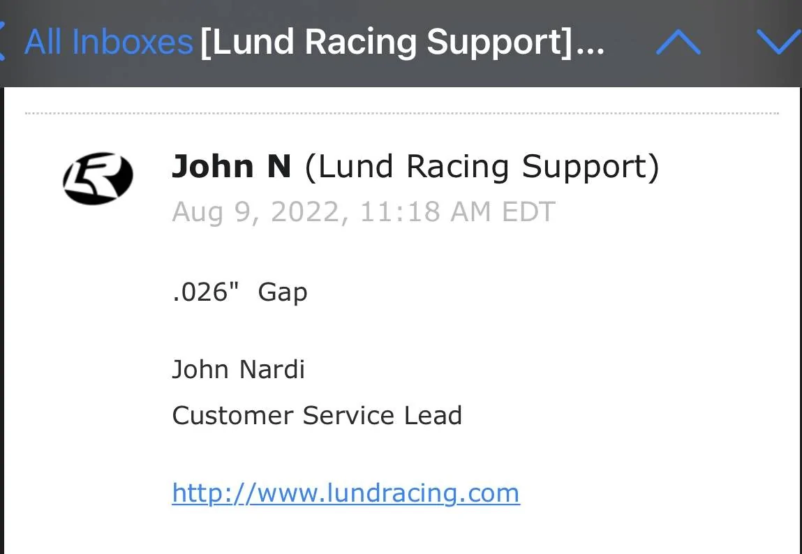

I had my car tuned by Lund and they told me .028 so if nothing else check with your tuner.
Edit: I've got the same plugs (good ol' beefcake special)
