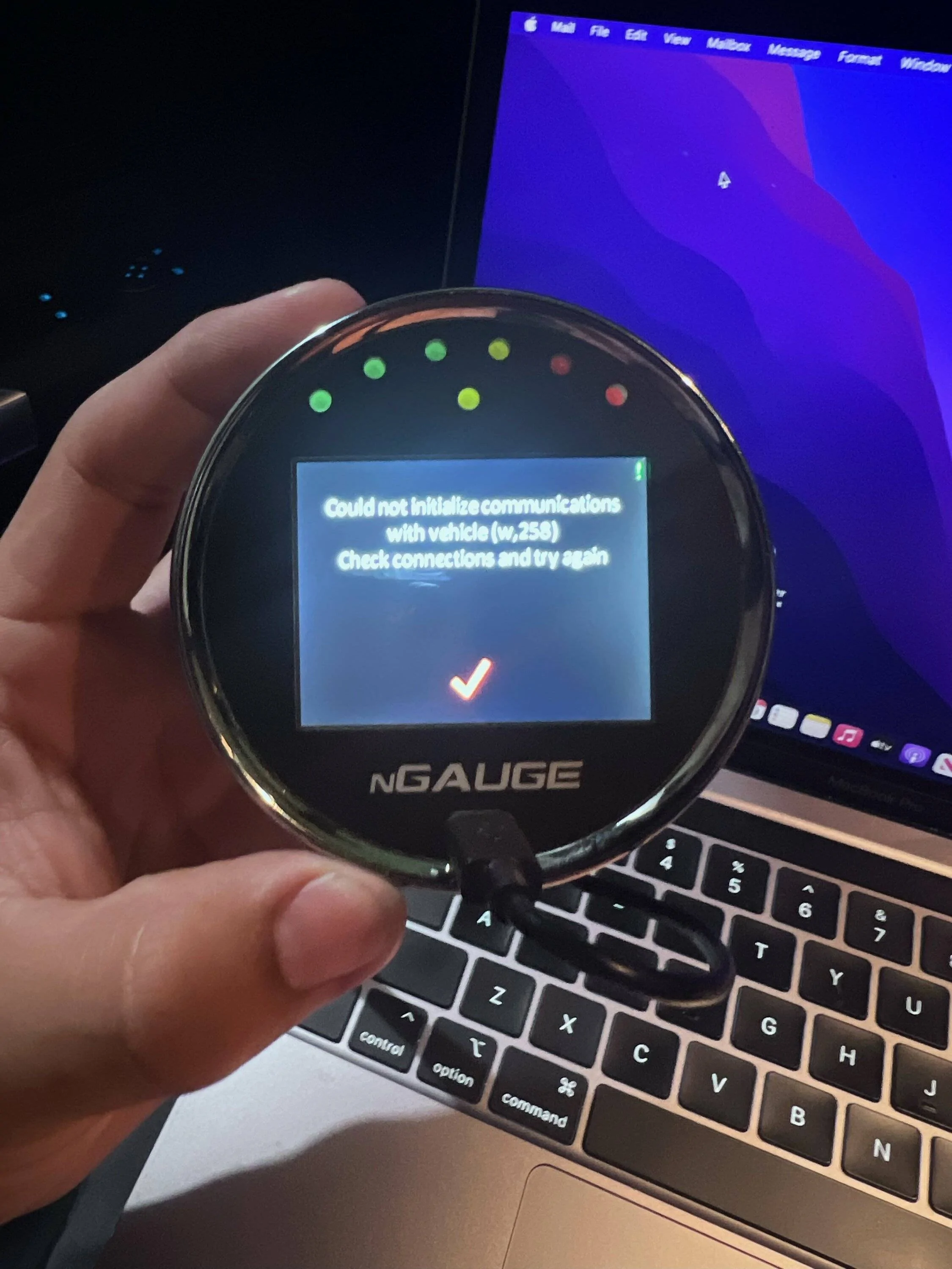

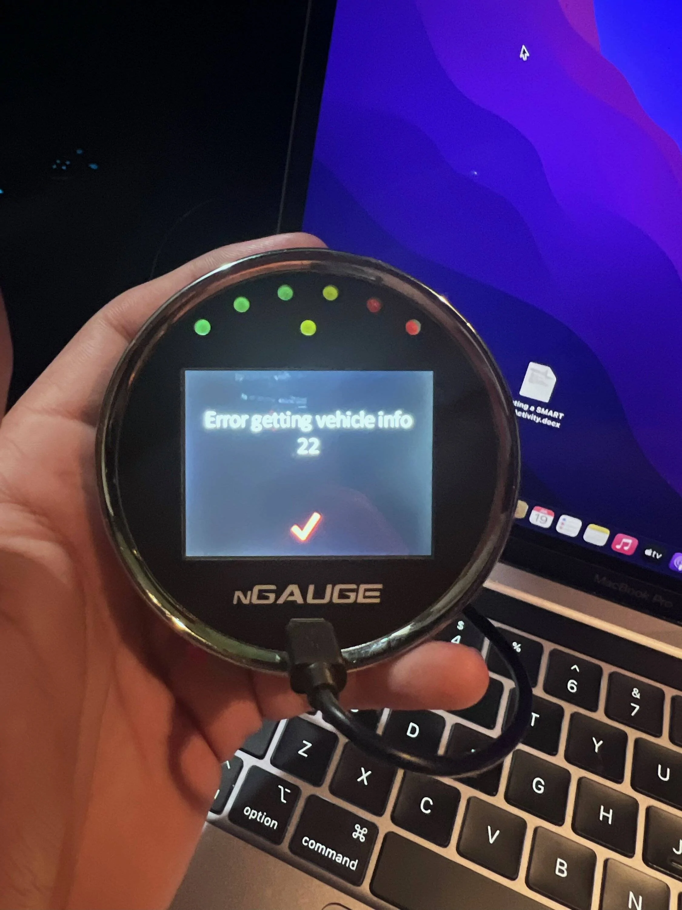

Just got my 10r80 and my ngauge wont read my car. It says “Make sure key is on” And then says no vehicle was detected. I tried using a different cable and it still didn’t work. Tried the gauge on my truck and same thing. But the day before i put the Jlt intake on my car the gauge was working and read my codes now that i’m getting my E tune it doesn’t read it. HELP!!

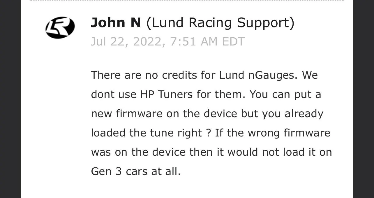

Lund told me said that I wouldn’t have been

I’m barley getting E85. My car ngauge wont read my car at all. Tried so many times and then one time It worked and I was able to get the 91 tune but it says once i got it it said turn vehicle off for 10 second and turn back on and the car wouldn’t even crank so i had to jump start and it turned on. Now that it’s on i’m trying to data log but it won’t read any coms.

So lund told me that if the wrong firmware was on the car then I wouldn’t have been able to get the 91 tune. I have 91 tune right now but when I try to datalog it it doesn’t read any coms.
Did they give you a solution?
