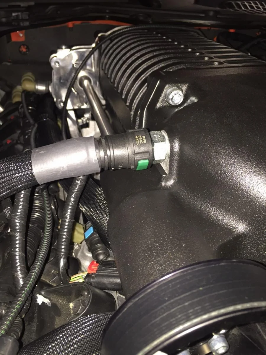

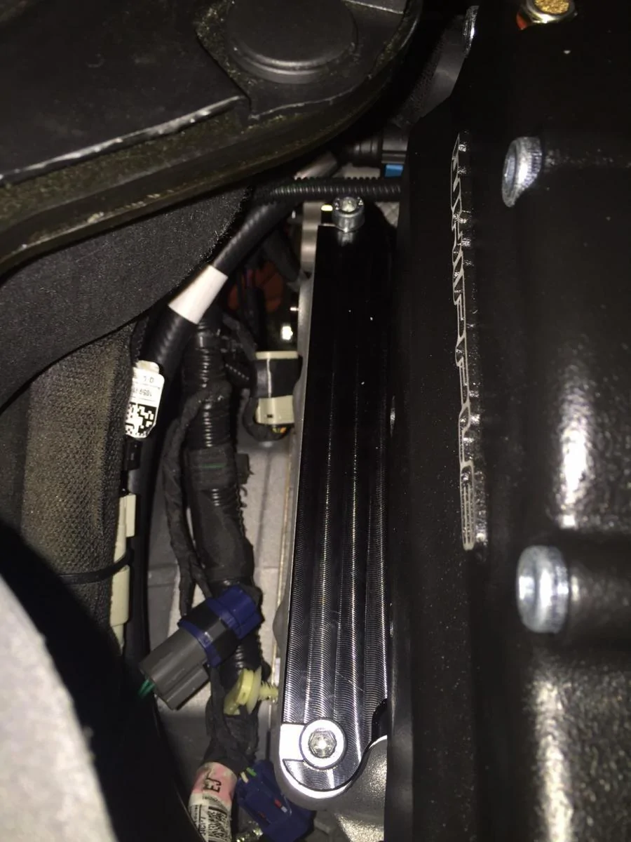

Did you check these things I mentioned above?Is your bypass hose connected to the nipple on the drivers side towards the front of the intake? Also check the Whipple lower manifold it has 2 other 1/8 npt ports that should be plugged, make sure they have plugs. Your positive your Whipple intake and supercharger are sitting flush on the there surfaces with nothing in the way?
