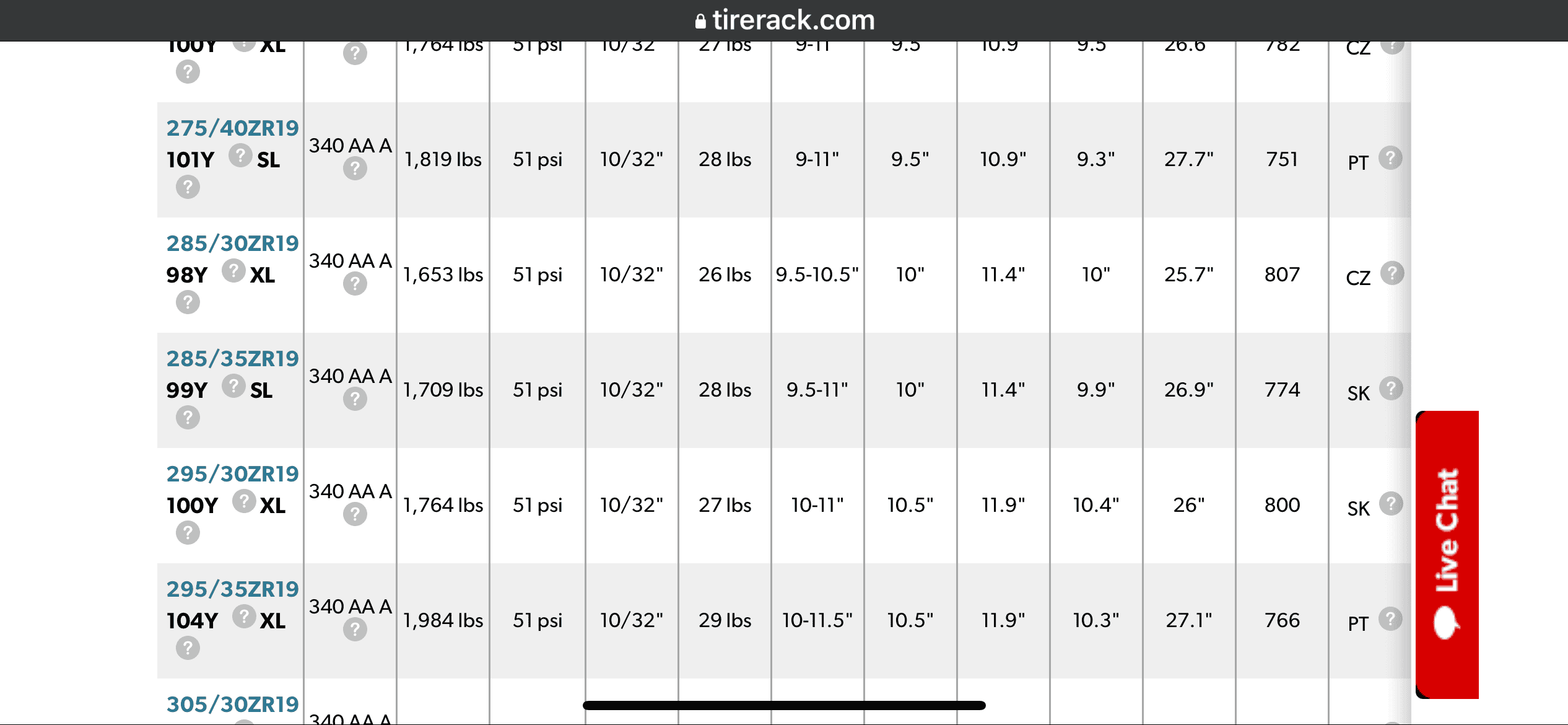

Hey all, so I am contemplating new summer tires for my 21 Mach 1. I have about 9500 miles on the stock non-HP staggered setup and when I run the Flex tune with E85, I just spin through 3 gears and can't hook up. Seems like I have good tread left and I store them in my heated crawl space in the winter months so the compound should be good. I only run 93 on the Flex Tune in the Winter with my Continental DWS Sports 275/40R19 all around and they hook up much better.
What do you guys think the issue is?
If I were to switch the rears out first to a Continental DW sport 295/35R19, could I keep the PS4S 255/40R19's up front or is this too much of a stagger and are 2 different types of tires front and rear not advisable?
Equal or greater Tire diameter in the Rear is important to me for how the car looks and sits.
Thanks for any advice or input.

Oh, I thought the DWS tires from Conti were all seasons. What is the width of the rear wheels, 9.5 inches? If so, you really don't get much benefit from going wider than 275. I wouldn't go wider than 285.

If I recall, the non-hp setup is 19x9.5 front and 19x10 rear? If so, you could do a 295/35 PS4S in the rear. 285 is ideal for 10” wide but 295 works. It’s a slightly shorter tire than the 275/40 tire you run in winter.

Yes, front is 9.5” wide and rear 10”.
The 285/35 is not enough diameter for me so I have to go to 295/35.
Biggest question I have is it ok to have different brand summer tires front and rear and is 255 to 295 too much of a difference in stagger?
Eventually I’ll go 265 up front when needed.

I wouldn’t mix brands, the compounds and tread patterns are different and could lead to some unpredictability in a loss of traction scenario and in handling in general. 255 up front and 295 in the rear is probably starting to push it a bit, 265 or 275 up front would perform better with the 295’s in the rear.
