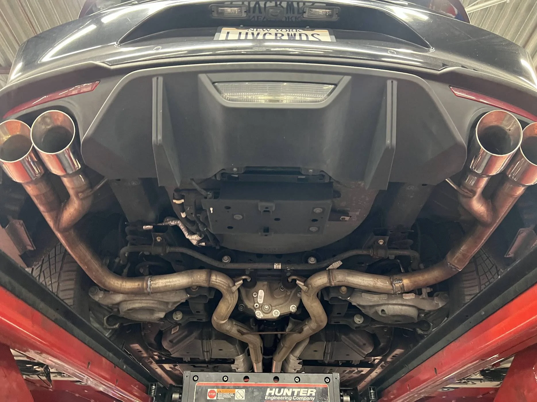

Hey all, first post on here. I have a 2018 GT that is currently straight piped minus headers and that needs to change. The car is essentially true dual to quad tips.
Current Setup:
Stock Headers + Cats --> Resonator Delete (no X/H pipe) --> MBRP Pro Axle Back.
I'm looking for options that won't break the bank that will quiet the car down enough and help with some rasp, but will maintain a good amount of volume. Some of the options I've read about include throwing some bullet style Vibrant/MagnaFlow/Borla resonators in, ACCELATEC Resonated X-pipe, or just straight throwing the OEM resonator in.
Just curious if anyone has experience with any of these options or would recommend anything else. Also curious if there are any mufflers I could throw in before the tips on the Axle-Back. Staying with some family for college and neighbors are not pleased in the mornings when I leave at 5:00am šŸ˜…
View of Axle-Back and part of Resonator delete
