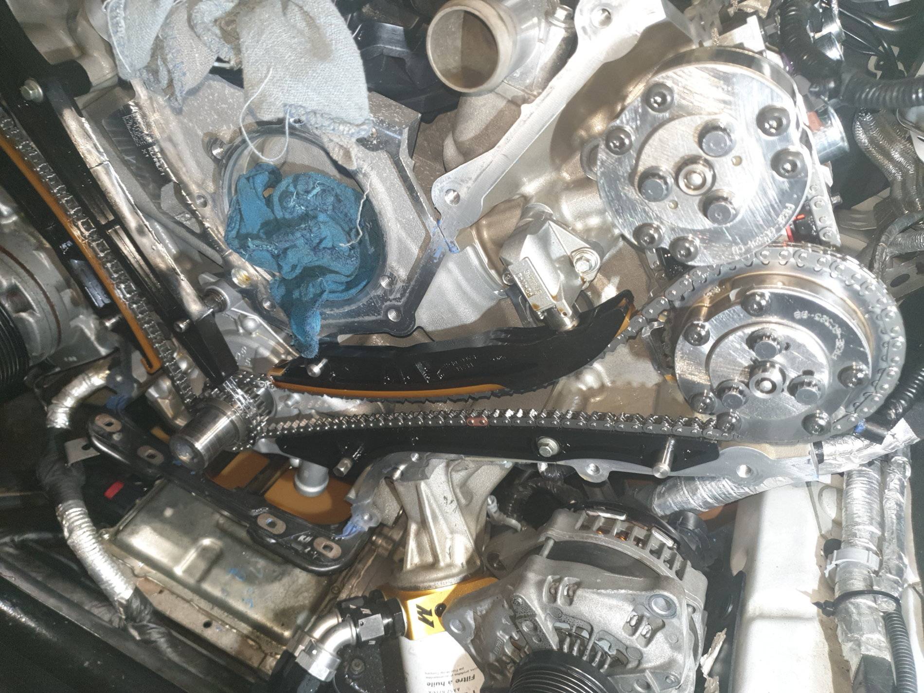

It is very highly recommended. Whilst you are at it, New chains (gt350) they cost 70 bucks and are 10% stronger, crank sprocket, MMR Secondary bracket and ATI Damper.
Then shut that sucker up and forget about it. Depends how long you want to keep the ride though. I'm keeping mine for life so I thought why not.
I did all those when I put the Kenne Bell on. I helped the tech put the parts on. Took us about 6 hours start to finish.
When mine is idling, the motor is so still that you wouldn't believe it was running.

2000 bucks is steep indeed but as you say. Peace of mind. I was also worried about harmonics so thats why I justified the ATI Damper. To be fair, it is a lot of work getting to that oil pump. I had to do it twice. There is a story behind that. I bought some aftermarket chain guides and Tensioner too and the Tensioner weren't kosher. Currently going through RMA... Let's see what happens.
