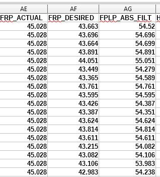

My question is after install and contacting lund for my supercharger tune.
They came back to me saying my High Pressure side is reading low pressure.

Lund is telling me that they should be reading 900psi for FRP_Actual in the datalog and it’s reading 60 +/- where I have my regulator set to. T
So I can’t proceed with my tune until I fix it. Driving me insane.

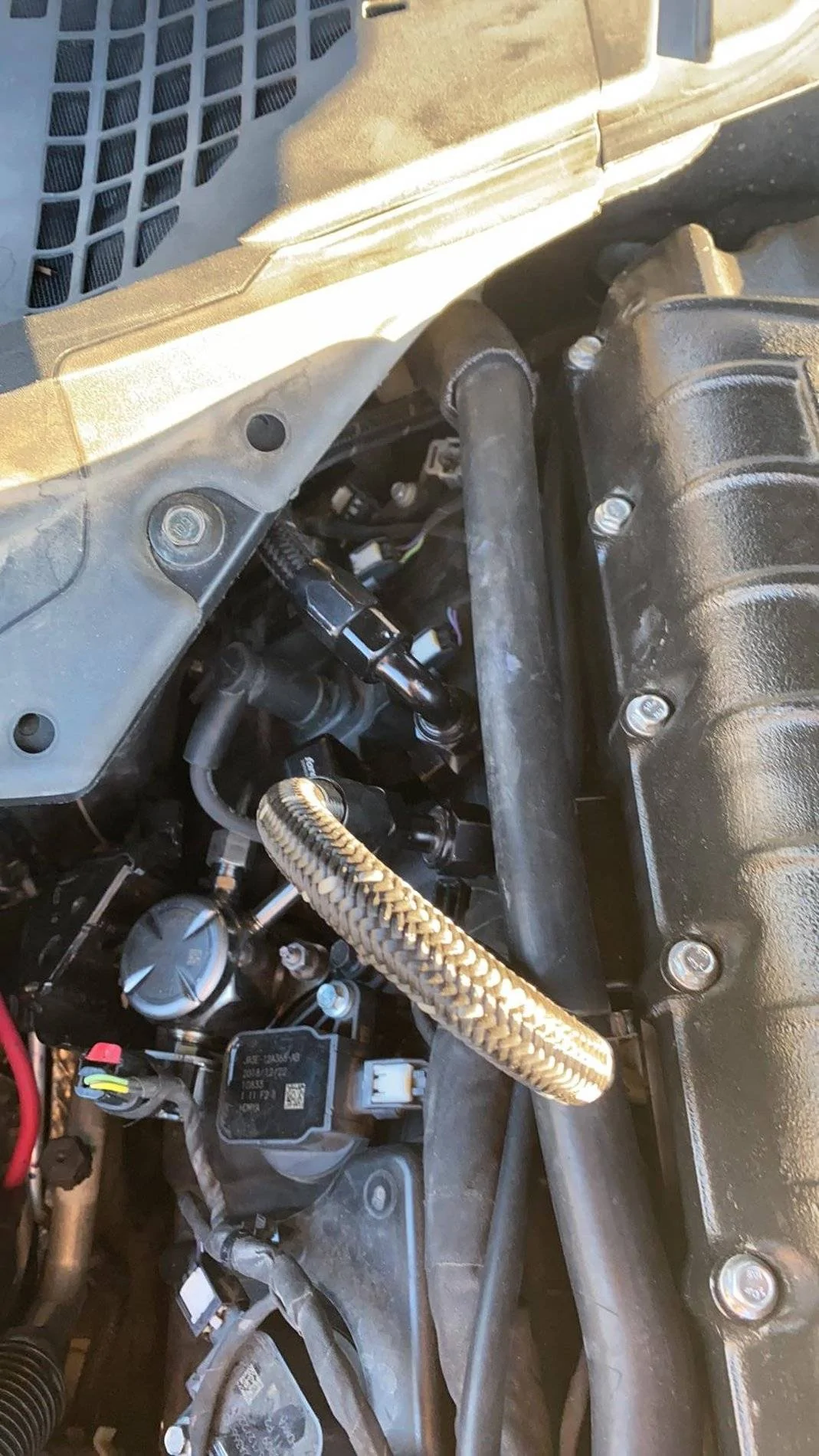

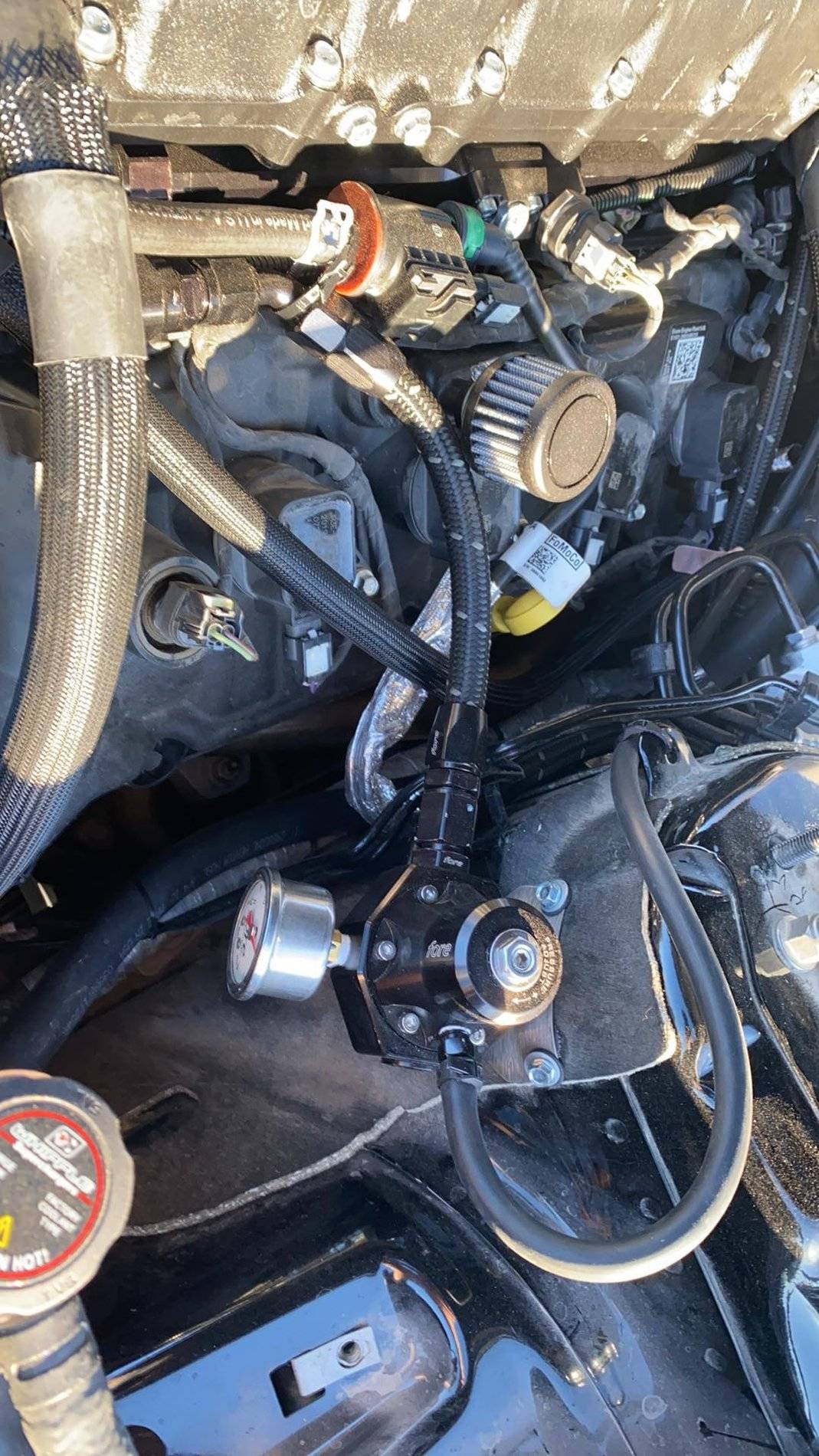

I’ve uploaded the pictures.
Update on some stuff, the system was used and missing some lines. I ordered some more so I can connect the second regulator.
the feed goes into the T fitting that is attached to the DI Pump and rail. Then goes through the rail into the regulator on port that side, then returns.

Is the return on the bottom for the fore regulator? I only ask because I can't see it.
You should try to remove the boost reference and go with a 60 PSI base and see if that fixes it in your log.

Yeah, the return feed is at the bottom of the regulator. I’ll remove the boost reference today and try that out. I did do some troubleshooting and unplugged my sensor to see if I get any different readings.. same, so maybe a faulty fuel sensor?

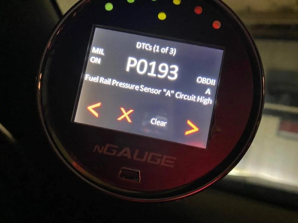

This is the code I throw
I looked up that code, @Kona 18 runs a single regulator You shouldn't have a problem with this single regulator setup.
Have you ran E85 and 93 in your system? Check your filters to make sure you're not clogged up anywhere.
you can subsequently try to dead head your system like stock: Feed to Regulator, Driver side to passenger side to HPFP. Set to 58~60PSI
See if that recovers the system
