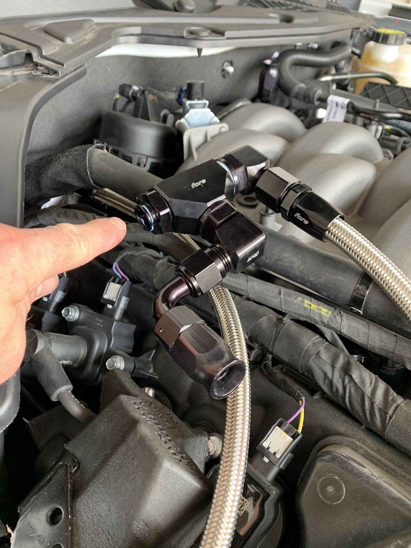

Fore said to hook up the DI pump to the third opening on the T block, where is that?

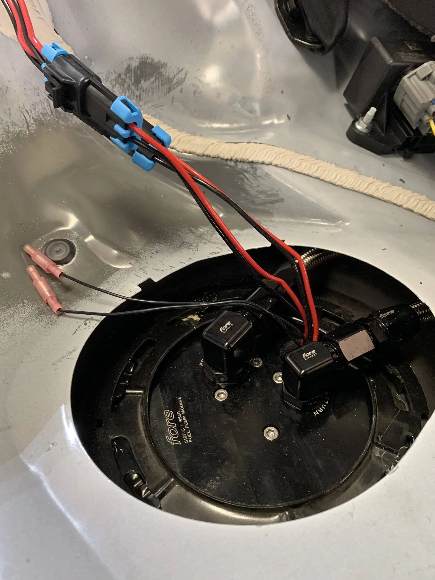

Where do the two pink wires coming out of the top of the fuel hat go?

Im in the same boat about wiring. But the first photo - T block what you are pointing goes to the high pressure right below you hand ( foam covering it with nipple sticking out)
Ahh, of course! Thank you!

You're literally pointing at the third spot that goes to the HPFP. Remove the stock hose off the HPFP, put the T block on it and you are done with that part.
The 2 small black wires are your fuel level wires, you have to cut the stock wires off the stock plug and connect them to those 2. polarity doesn't matter for the fuel level

Questionable wiring on the fuel pumps the wires have been crushed/pinched.... Hopefully you didn't break many of the conductors.
