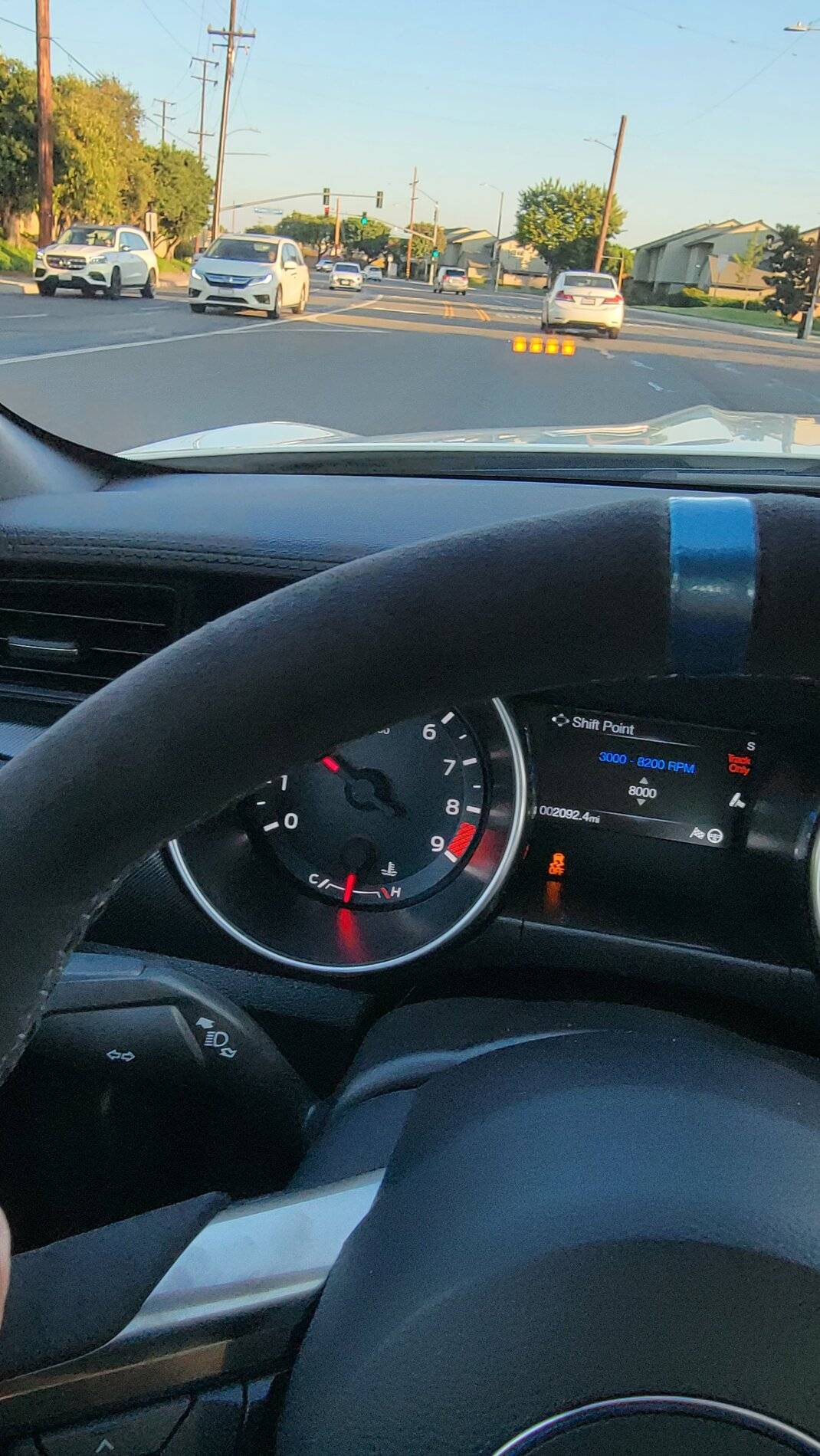

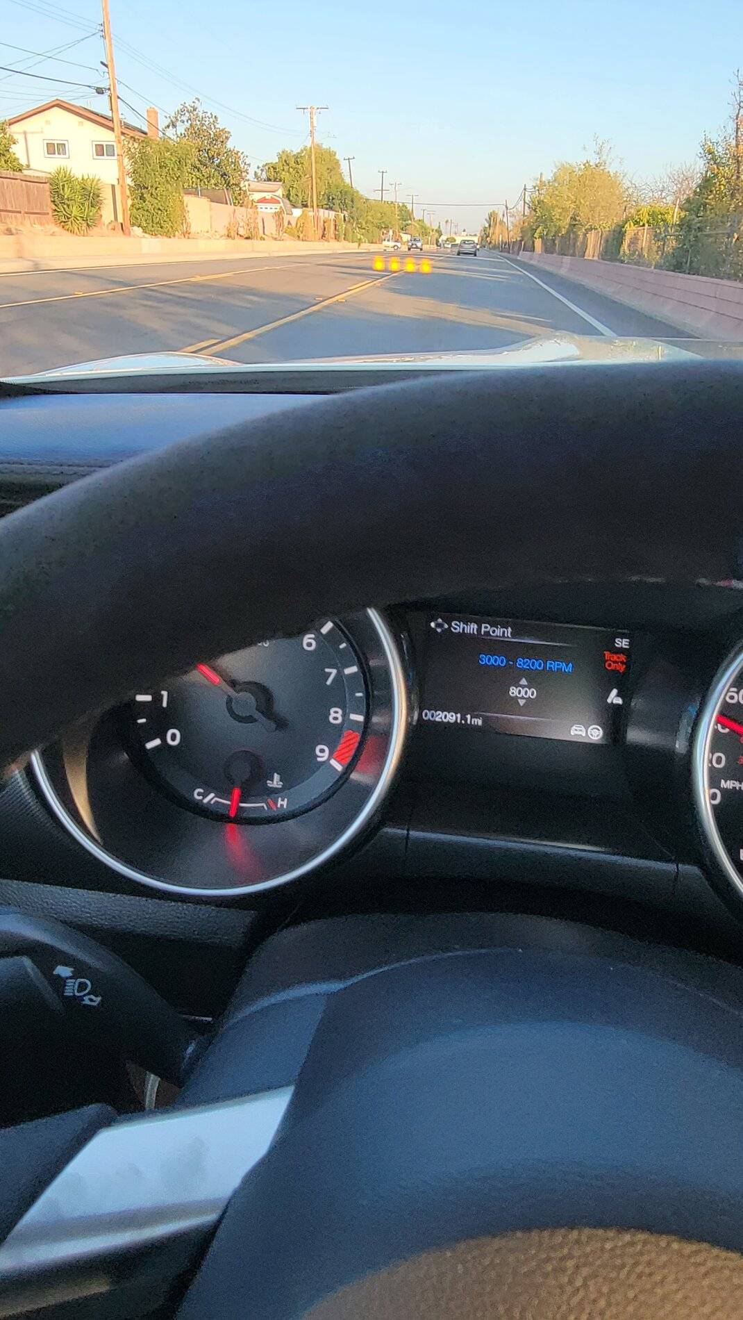

3. My shift indicator comes on way too early. It was initially at 3000, so I bumped it up to 8000, but it still comes on way too early, like starting at 2000 rpm. Changing drive modes doesn't seem to fix it. Please see pictures.

Just FYI if you are in 6th on the highway the valves close even if the switch is set to open. Keeps the cruise quiet and drone free. If you want to cruise with the valves open, keep it in 5th.
As far as the shift indicator goes, the number of lights increases with RPM. So even if you are at low RPM you will see 3 or 4 lights.
Have fun voodooing; just maybe keep the TC on for now :crackup:

I have my shift light set at 7500 if I remember correctly. If you are set at 8K the lights should start to show around 6K but don’t hold me to it. Your lights coming on that early is strange.

The lights shown are not the shift light, those are only an indication of where you are in the rev band. They will go red at the top of the band and the buzzer will sound if turned on. RPMs come quick so I have mine set at 8k.

Oh ic. That must be why it was pretty quiet, but still got some power in 6th that I didn't need to downshift much. For now sport is where I will stay at :captain:
Hmm interesting. Thanks for the info. I will lower the indicator and test it out. I haven't rev'ed it past 6k yet. It's just way too much rev to get used to lol.
Yep, the hoods tend to flutter a bit on these at higher speeds. It's a bit unnerving sometimes but normal.
Try changing your shift light to "track" mode. That will be the one where the LEDs start at the outside edges and work their way toward the middle. The mode you're using is a bit busy, and (for me at least) it's hard to tell where redline is. It's not a drive mode change, it's a feature specific to the light. You'll find it next to the redline selection in the options.
OP, Congratulations on the Shelby! I just moved on from an e92 M3 to the GT350 a few months back. A lot of similarities but many differences too.
Once I found out about the track setting for the shift lights, it is what I use. I much prefer it to the other setting.
