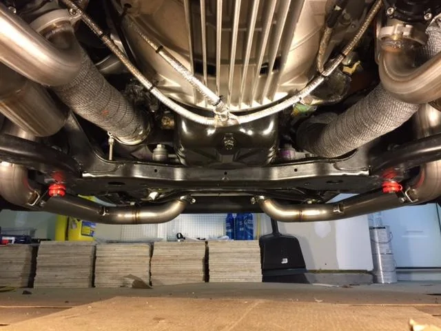

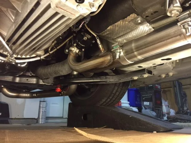

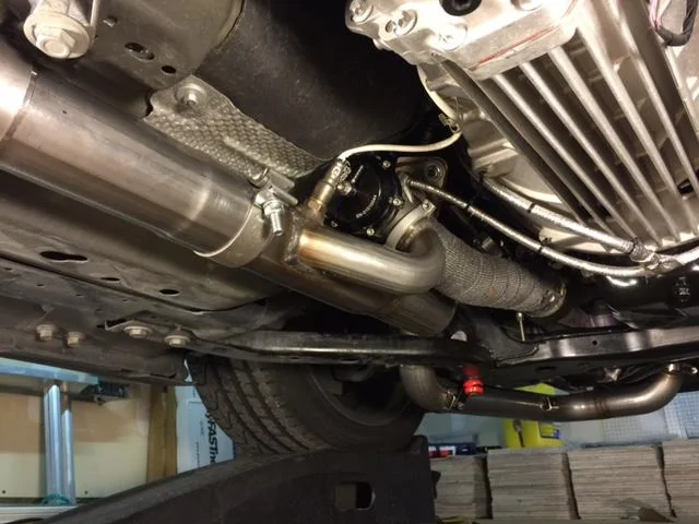

Not sure about the ground clearance you speak of. The down pipes run under the a arms along the k member. My car is lowered and there's no issues. I did notice the car dropped .5" after the install.
That is good to hear on the tuning! That removes all my worries on my turbo setup then.
The car I saw had the 1" drop springs, and the pipes were less then 3" off the ground. My kit will be real similar, but we measured mine at stock ride height and had just over 6". It must be the tire/spring combo on the car.

What is your ground clearance under the car? The one I saw in person had under 3"

As for ground clearance, its pretty tight with the downpipes running under the a-arms. I'm lowered on Steeda springs and the front end came down some more and looks closer to the Sportlines now. I am a bit afraid of speedbumps, driveways, etc now because I already scraped once.
