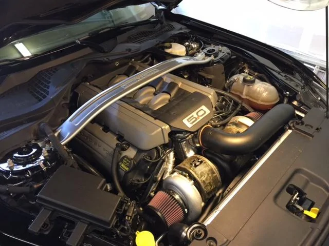

any videos?
badass bro...how long was the install time? thanks
I'm liking the heat wrap on the throttle body electronics - was that included with kit? How long is the install? Any bending of a/c lines like the 11-14 kit?
I'm in Houston. What are the tuning plans? Canned tune, data logging, or a local shop in Houston tuning?Yes a roll of heat tape and lava heat wrap is included. I would plan for at least a 3 day install. I did mine over a week but it included installing the oil pump gears, some gauges, and modifying my exhaust. As for the A/C line, you will need to push it down ever so slightly to get the passenger filter on the turbo.
How is your tuning going? I know of some other 15 hellion systems getting installed having problems. Missing tables or what not. I'm hearing SCT and HP tuners hasn't quite cracked it yet.Yes a roll of heat tape and lava heat wrap is included. I would plan for at least a 3 day install. I did mine over a week but it included installing the oil pump gears, some gauges, and modifying my exhaust. As for the A/C line, you will need to push it down ever so slightly to get the passenger filter on the turbo.
