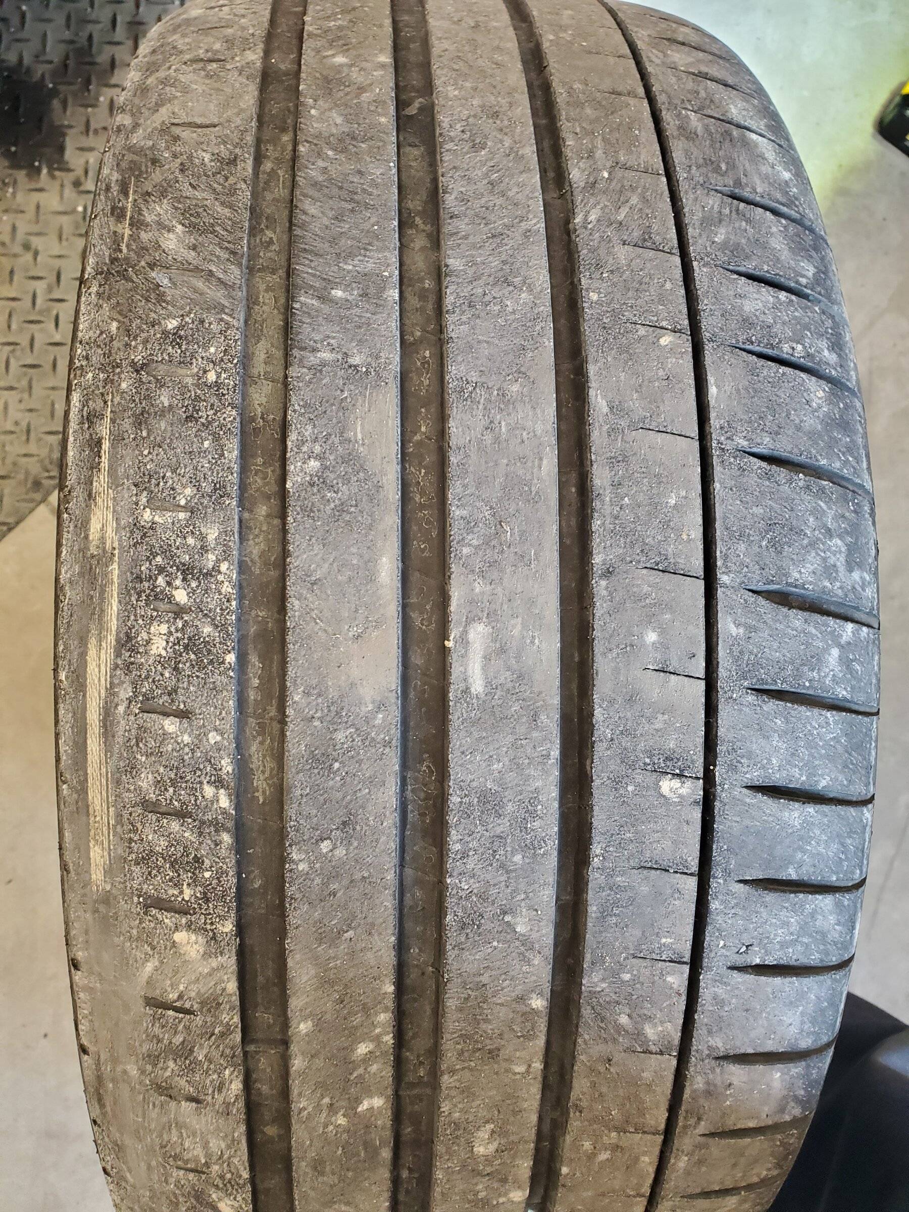

Hey guys. I have been working on my car and had the wheels off - the fronts don't look good at all! The inside is showing the cords and the outside is not down to the wear bars yet. I think this is fairly common with these cars (PS4s tires) but maybe not. I'm planning to get new front tires and get the alignment checked. Is this type of wear typical for these cars and/or do I need to have the shop use a different
alignment spec? I'm wondering if the uneven wear is due to some type of performance alignment setting - as always - thanks for the help!

In my experience (3 sets of Michellins replaced so far) this is pretty normal end. While its annoying to have a tire with plenty of tread get thrown out due to wear on just that inside edge, I have been getting 20k out of them, which aint too bad for summer tires overall.
still, getting the alignment checked when you replace tires will ensure they don’t die early due to easily correctable alignment issues. Alignments do drift over time.

That looks more like it's been rubbing on the strut rather than just having overly negative camber. Are there marks on the strut?
I have the wheels back on now - I guess I didn't look at the struts. Wouldn't I notice if they were rubbing on something (sound, feel, etc)? The wheels are the stock PP1 wheels with the factory tires and no suspension mods so I guess I wouldn't think they would rub...

that is a TOE problem, not camber. Demand zero toe.
You can double check that by running your fingers over the outside tread along the circumference of the tire. Toe error can cause "feathering", where you can feel sharp edges across the trade blocks in one direction or the other.

It looks like your car is toed out too far. Typical wear for that kind of issue.

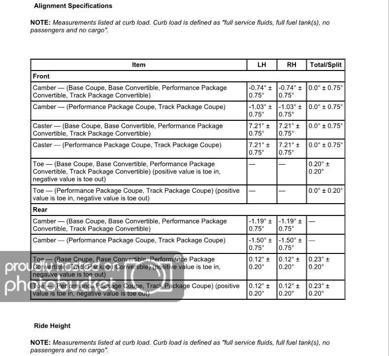

it's been posted all over the forum. And there is a media.ford.com link I can't be arsed to dig up again. Despite the below, you want <=0.1 TOTAL toe (half each side) if possible, 0.2 TOTAL toe at worst - for the FRONT. Rear is fine as depicted.

it's been posted all over the forum. And there is a media.ford.com link I can't be arsed to dig up again. Despite the below, you want <0.1 TOTAL toe (half each side) if possible, 0.2 TOTAL toe at worst.
Thank you!
