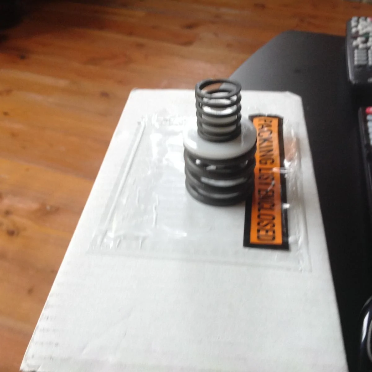

I have searched the Forum and have not seen anyone reporting this new clutch spring design. I went to replace my clutch spring today with the Steeda spring.
I was surprised to find the two piece spring instead of one heavy spring. We were able to remove it with out using vice scripts. I will attach a photo of the spring assembly. The top and bottom plastic pieces are the same as shown in most pictures I find on the forum.
Has anyone else see this on their cars. I received my car on 4/7/16

Thanks for the welcome, however after reviewing all 10 pages of the thread you posted, I still find any reference to the two piece spring. Did I miss it. The only photo' and videos I have seem that I could search for shows a one piece heavy spring. Obviously from reading above this has been changed for sometime. Are people having the same problem with these
As they ere with the single spring. I have only driven my car for about 20 miles after getting it ship here. It spent part of it,s time at a ford dealer tracking down a problem with the fuel pump wiring.

I have to say the GT350 OEM spring feels a lot better than the OEM one on my 14 GT500 and 15 GT. Not having any issues with it so far. I had the Steeda on my GT and don't feel the need to make the swap.

I still like the single Steeda feel the best.

I found the OEM spring to feel - well vague. The Steeda replacement was a noticeable improvement with no significant change to force needed to depress the clutch.

I honestly pulled mine on my 15 GT and think it feels best gone/no spring at all. Will do the same to my 350 day it arrives.

I took the spring out of my Ecoboost and it was much better.
Then I ordered the Steeda spring before I got the 350 and installed it an hour after I got the car.
It's simply fantastic.

I wouldn't say there's anything "wrong" with the Gt350 dual spring setup. But, the springs do influence the clutch action and feel quite a bit, and creates some vagueness in feeling where the clutch engages. I left it stock for several months to give it a try, but ultimately decided that it masked clutch engagement too much and creates dead spots. So I swapped to the Steeda spring which I find is much, much better. Consistent, linear, easy to engage the clutch and no dead spots. Best sub $20 mod for the car so far. Since I drive in traffic and urban areas quite a bit I decided to stick with a spring to provide a little relief on effort.
