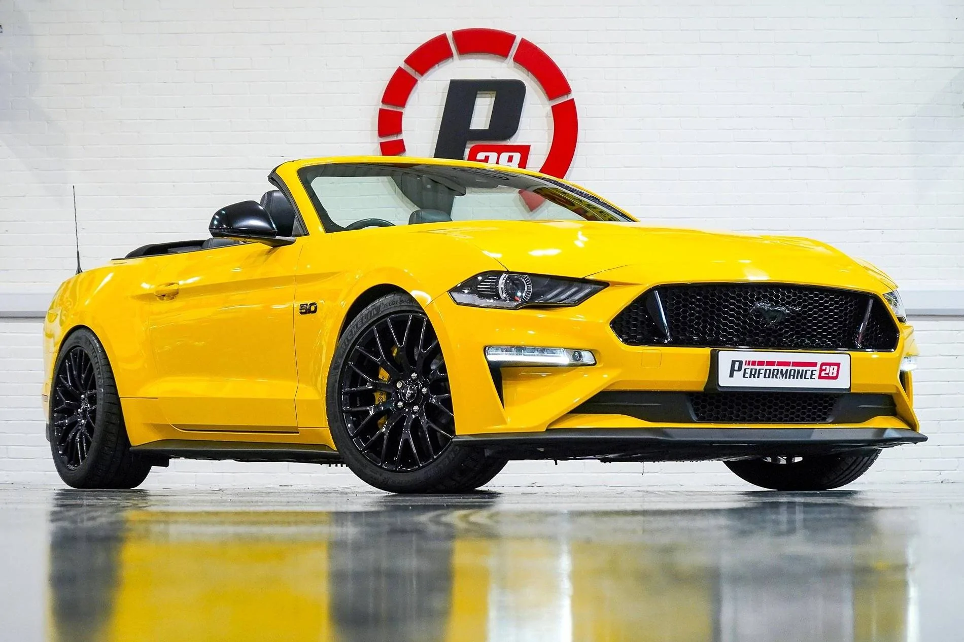

So last one is gone and dusted.
Decided to go for a bolder spec and tick off ‘owning a convertible’ off my list too.
I already have two questions:
Didnt all facelift models come with Rev Matching?!! Its not in the menus anywhere.
Its also without B&O or Shaker so no subwoofer in the trunk, any suggestions on what aftermarket option to go for?

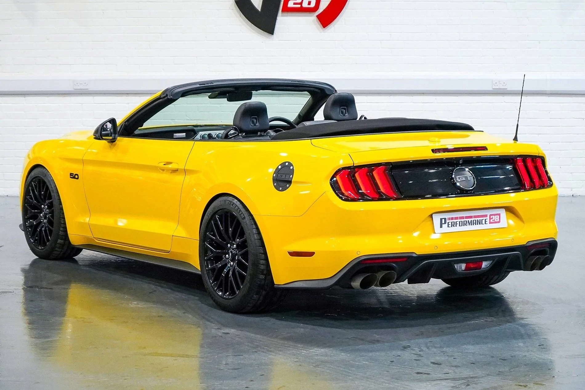

Nice !
Spacers, springs, taillights, some colour coding - what else has been done ? :like:
I ‘think’ rev matching came on the 19’s ? (But not totally sure)

You covered most of them🙂. Carbon shift knob, oil cooler upgrade.
car manufacture year says 2019 registered May 2019. I couldn’t find any details on facelift ones in UK that didn’t come with it.. hoping its a software glitch. Loved it in my last one
