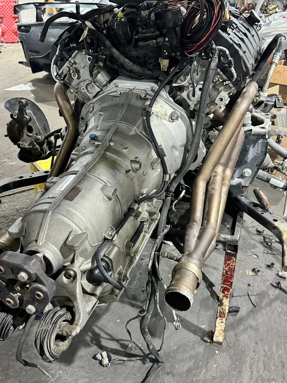

i have a manual 2015 gt. Recently saw a post of a gt350 doing an 8hp swap. I liked it. I’ve driven several cars with 8hp trans and they drive nicely.
I got 8hp90 trans from a bmw
All the adapters i need
Will do link ecu standalone/piggyback (it’s the only supported ecu that a local tuner can fully support my project) other than motec which is way above my goals.
turbolamik tcu
If the trans swap goes smoothly, will boost the car. 8hp90 should handle 700ft/lbs safely

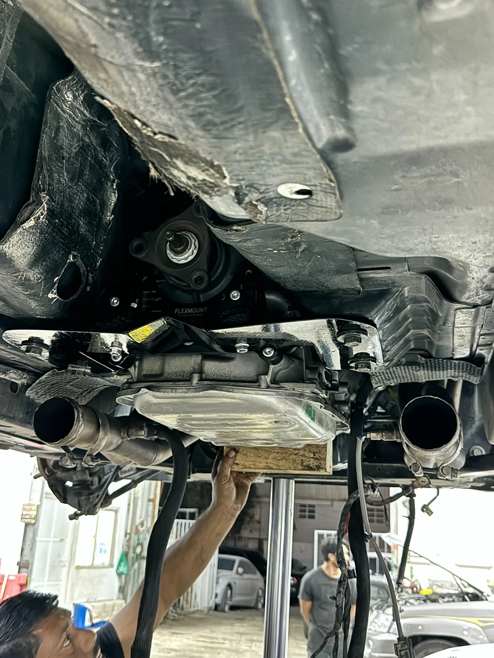

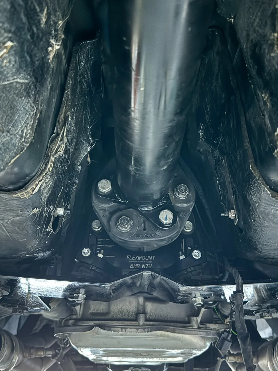

transmission installed, shifter installed (dct shifter), drive shaft installed (stock shaft, replaced the transmission side with bmw end, welded and balanced)
90% of wiring for the link ecu and turbolamik are done
car should be running by next week i hope
adapter kits made it all easy, minimal modifications were needed
transmission fits nicely
domi-works for trans and converter adapters
domi-works universal trans mount adapter with custom fabricated body mount
jpc racing for flex plate

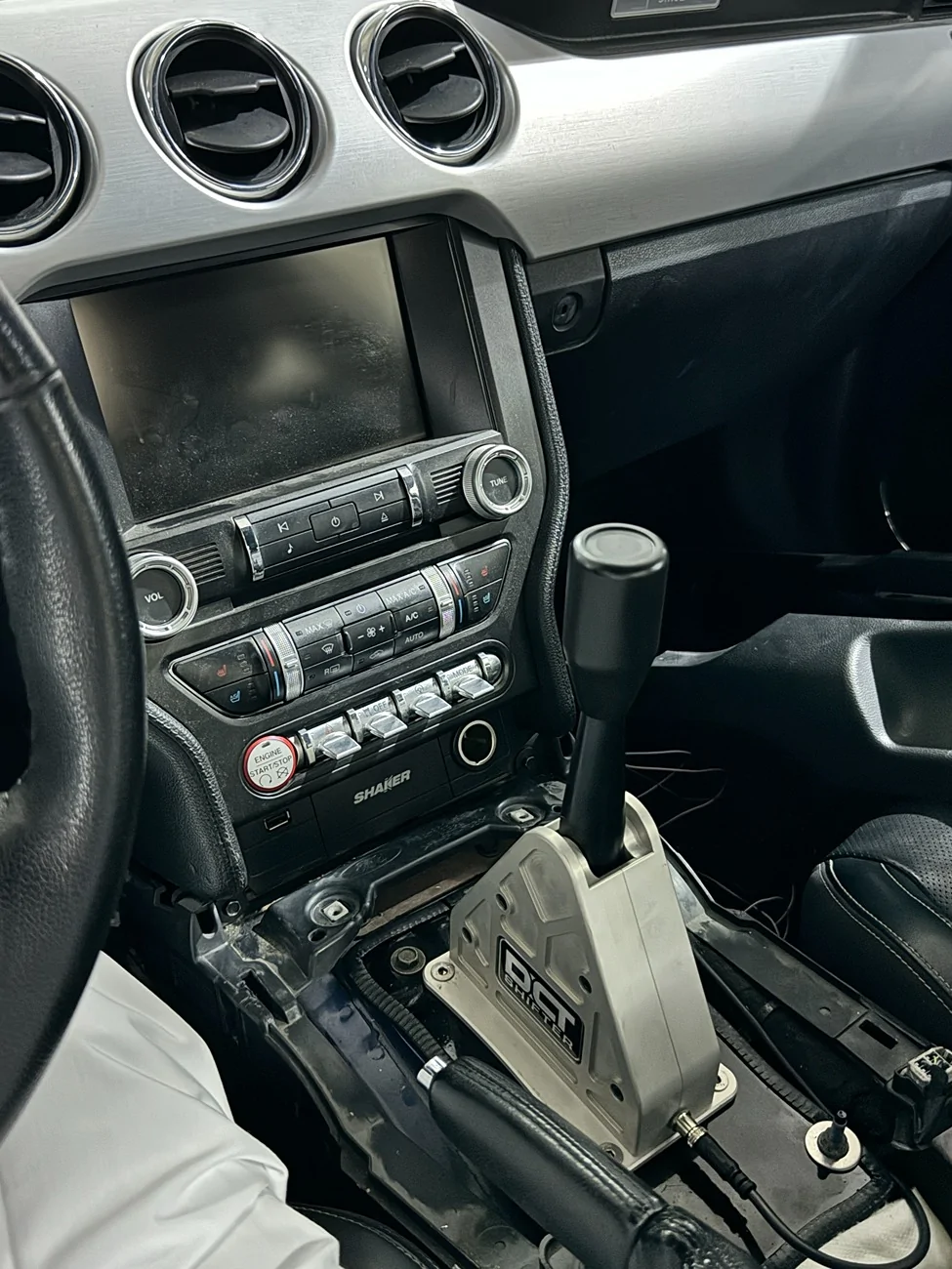

dct shifters E-shifter

Can’t wait to hear the DCT shifts and blips! That shifter is super nice too. Insane build
