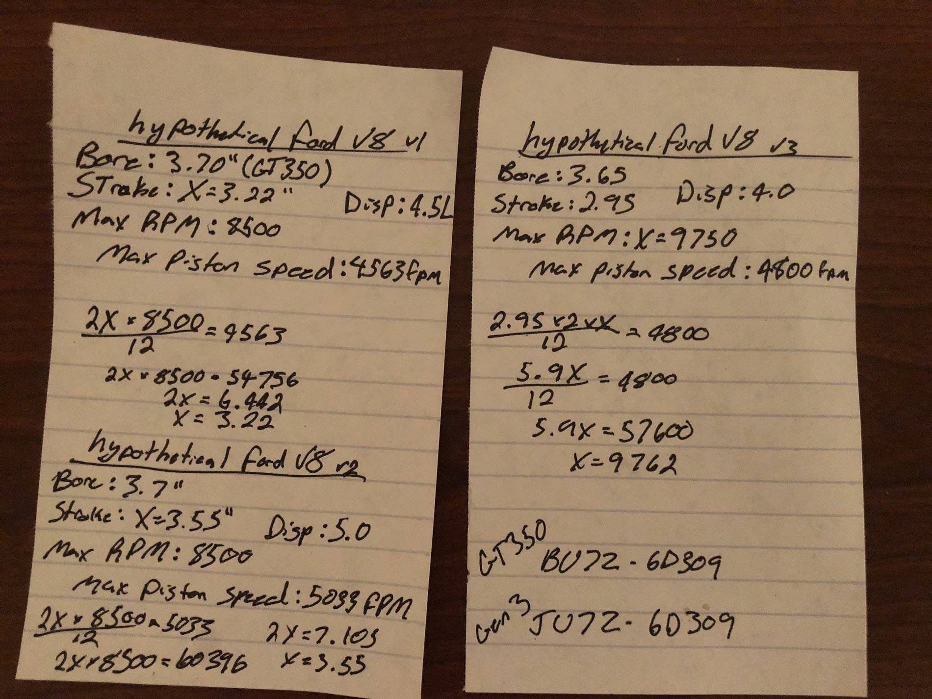

just remember that mass produced engines don't always have the tight tolerances of hand built ones. Not saying it can't be done, but there is a tradeoff in warranty costs, etc that would require a substantially higher price for the vehicle to reach these theoretical numbers you are calculating on the back of your napkin. The above costs also don't take into account the need for sturdier parts throughout the engine, from the crank/connecting rods/pistons to the block, chains, gears, etc. You will also probably need a beefier transmission, drive shaft, half shafts, etc. In short, an entirely revised drivetrain. After all, you are talking about 10s of thousands of units a year, not 3k or less, all with 3 year factory warranties, and many with 5-7 year extended warranties. That means the parts you say are already produced, really aren't.I still want to see the best features of the gen3 coyote, voodoo, and predator combined. 5.2 liter, 8200 rpm, low-compression, supercharged, and gdi. My napkin math says a bmep of 26.5 bar is achievable safely on pump gas, which translates to 815 ftlb and right at 1000 hp at 7500 rpm and all the parts have already been produced.
I'm not ragging on V-8s, I like them too, but my 2.3 Eco is smoother than any of the 302 V-8s I owned and on par with the 4.6L. It sounds like a Camry though.just remember that mass produced engines don't always have the tight tolerances of hand built ones. Not saying it can't be done, but there is a tradeoff in warranty costs, etc that would require a substantially higher price for the vehicle to reach these theoretical numbers you are calculating on the back of your napkin. The above costs also don't take into account the need for sturdier parts throughout the engine, from the crank/connecting rods/pistons to the block, chains, gears, etc. You will also probably need a beefier transmission, drive shaft, half shafts, etc. In short, an entirely revised drivetrain. After all, you are talking about 10s of thousands of units a year, not 3k or less, all with 3 year factory warranties, and many with 5-7 year extended warranties. That means the parts you say are already produced, really aren't.
