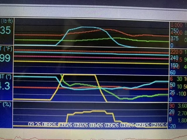

Sport, paddle shift on. It wasn’t ABS, TC or AT because those are separate torque sources and would have shown as such in the log. As I’ve said before, there are many torque sources and the driver is only one of them. I was simply giving one example of a time when the driver isn’t determining the torque output in the current gas engine, not looking for help diagnosing.
what was the gear and RPM?
3rd gear, 3000 rpm

No problem. Spark source went to “torque control” as well. Top blue line is throttle plate angle. Middle yellow is accelerator pedal. Bottom green is spark timing.

So I assume that the PCM decides whether to follow driver demand or trip its tip-in limit is based on how fast the driver physically moves the pedal. Any idea how abrupt this might be - IOW, is it like an either-or switch that always happens at X%/second pedal input, or is there any sort of ramping between the two conditions over some range of pedal input speeds? Is there any vague-ish range over which the tip-in limitations are not as severe?
I can see where having to wait a half second for engine response to catch up to what you requested could be annoying at times. Where I'm heading with this is that I suspect that inserting half a second's worth of nonlinearity in the car's handling response would be even more annoying/frustrating for a driver who doesn't care to play co-pilot to somebody else's programming. Wouldn't that be likely to happen with electric drive at one end of the car and ICE drive at the other?

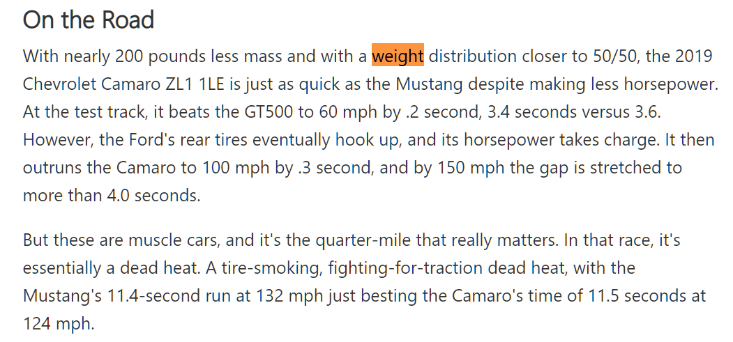

56% of the GT500's weight is over the front axle; That is bad. The GT500 weighs 4200 lbs; That is also bad. That is where you are going to find more performance out of the current platform. Not with more horsepower.
Here's an applicable excerpt from a C&D article:
There is a reason that the guys who race as ALL about weight reduction in these cars. It's not because they don't know what they're talking about.

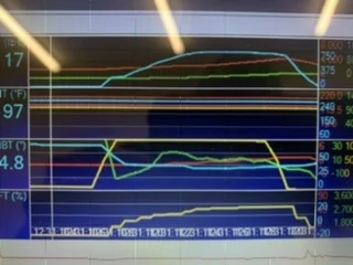

Well I got that one worked out. I disabled the “anti-jerk tipin switch” and now it blows the tires away instantly when I zombie-stomp it.
I tested it 4 times and it stayed in “driver demand” torque source and “tipin detonation ctrl” spark source. From wot pedal to wot blade 20 - 100 ms delay, which probably had more to do with polling rates than actual delay. Spark timing stayed in the mid teens rather than dropping below 0. Mission accomplished.
I just caution you that there are probably 20+ torque sources, plus air sources, spark sources, fuel sources, and many more, so don’t get hung up on this one.
