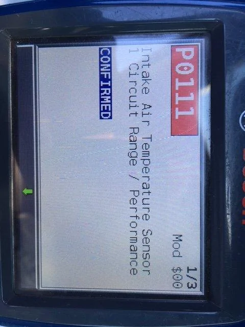

Decided to take the GT into O'Reilly's Auto Parts near where I live and ran the OBDII myself to pull the codes. It's pointing the IAT being at fault, or more specifically, anything to do with the IAT, which could be the unit itself, the wiring or possibly even the PCM.

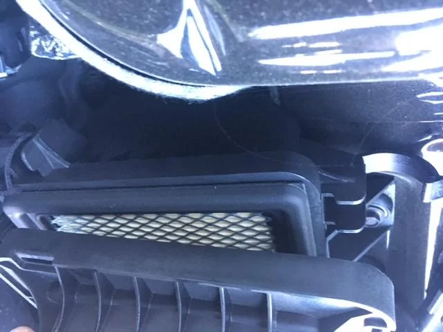

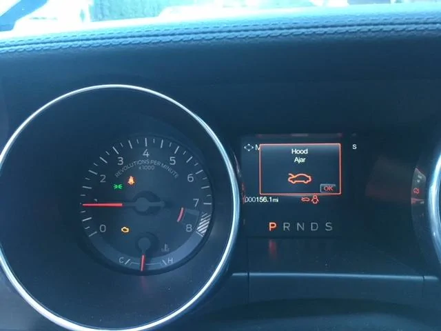

Added 3 pics. Yes, there's a filter. Here's the code (1/3, all were P0111, this was the only "confirmed"). Yes, there's definitely an engine issue at 156 miles...and before anyone asks, no it isn't because my hood is open.

"Engine issue" isnt it just the IAT sensor malfunction?
DRTII
New Member
Jul 15, 2018
Oregon
2018 Mustang GT
Quite honestly I don't know what to call it. The engine light came on. I pulled the code, says IAT. Is there a better word for it when the engine light is on?

Did you get anywhere with this? Mine just popped up with the same code except I have 11,500 miles on mine. I do have a K&N panel filter but been there since around 600 miles. My IAT has always read about 5 degrees higher than ambient temperature but pretty sure that is normal.

Not sure what it was but I popped the cover off yesterday, there was some crap built up in the filter (bugs, a couple pine needles, pieces of leaves?, not sure how all of that got all the way up there) so I cleaned out what I could. I also disconnected the sensor and reattached and cleared the code, hasn't come back on.

This is all that afore has out on the P0111, see attached.
