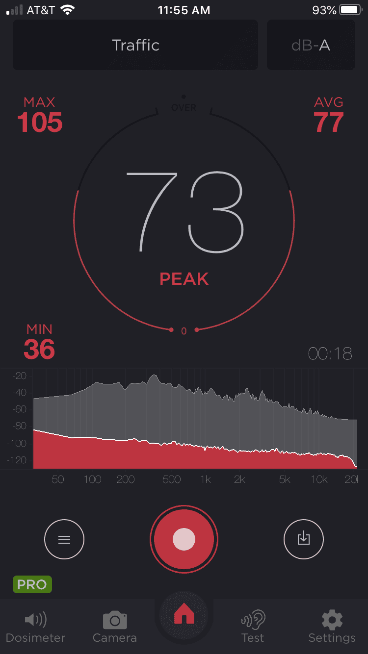

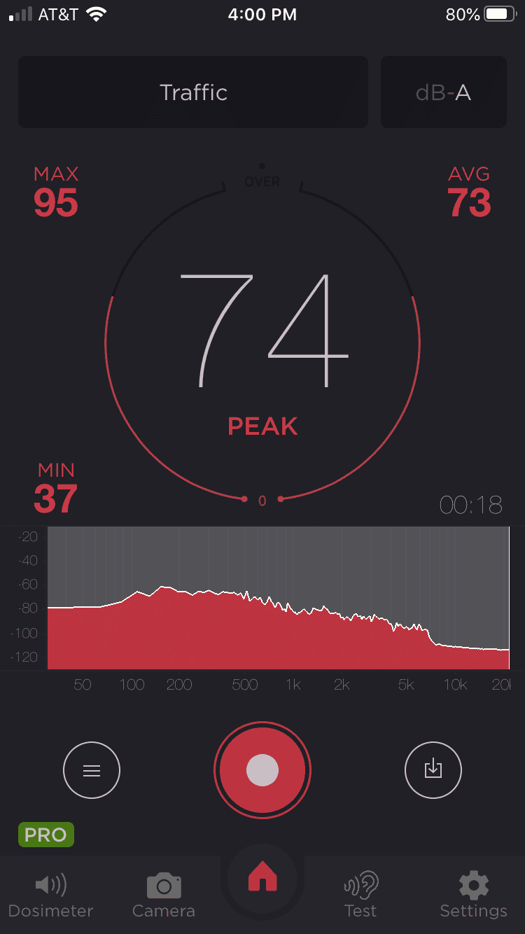

Here are decibel readings at 6 feet from the exhaust exit. First one is with the stock mufflers and a Steeda H-pipe, max blast at startup is 105 dB. Second one is stock resonator and Accelatec / NXT Step / SVE generic axle-back. 10 dB lower at startup and 4 dB lower average sound level with the stock resonator and louder mufflers.
