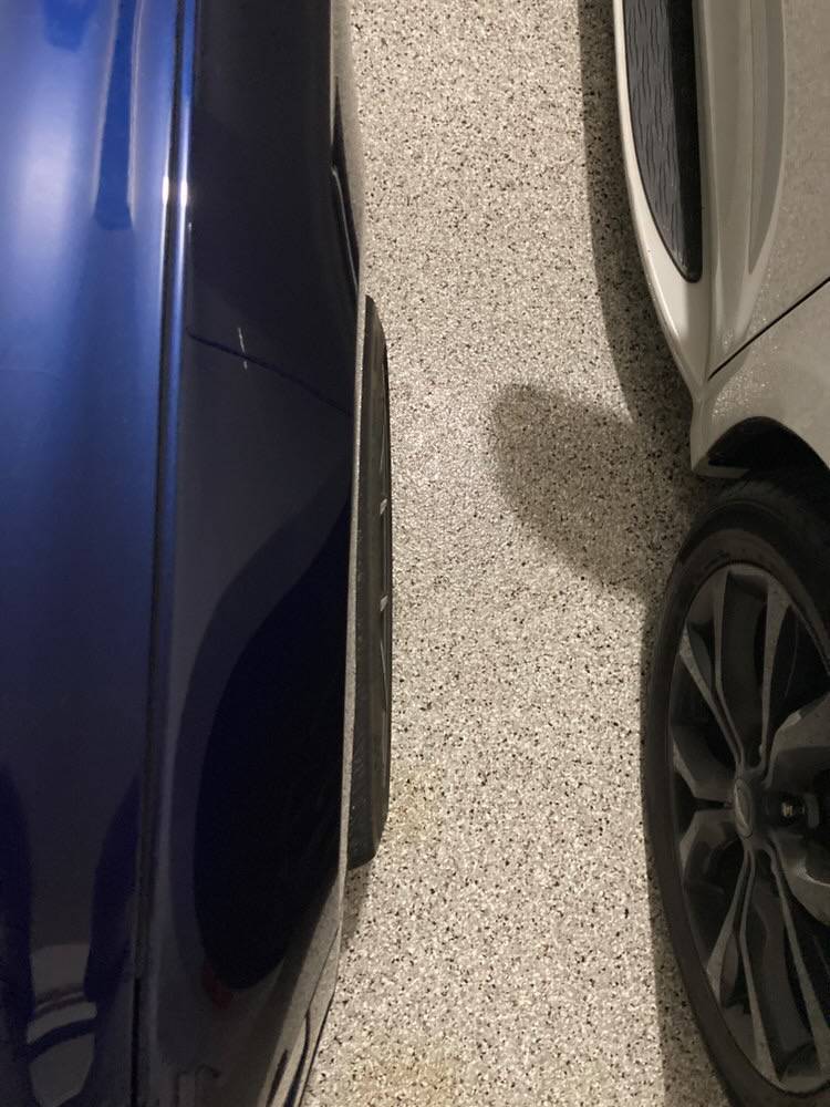

Had a buddy take a photo of his PP2 top down. I think I’m going to do a 285 or 295. That’s more poke than I want. Taking 20mm/.5 inches of width should fix that. Silly question does anyone have the part # for the PP2 wheel wells. I asked once and I think they were only 110.00 per side. As far as I can tell the belly pans are the same. That’s no bad to gains so extra clearance if you need it.
it'll pull the sidewall in but you see plenty of wheel in that picture.
19x10.5 ET24 4.3 6.2 PP2
19x11 ET24 4.55 6.4 what many people have (or ET27)
What Ford should have done on the PP2 was
19x10.5 ET30 4.1 6.4 avail ESR RF02, Curva C300
you should be able to go up to ET35 and 285 tire but may need a 3mm spacer for peace of mind or if the tire has a fat rim protector on it.
