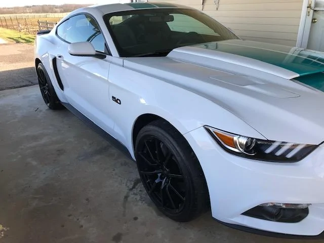

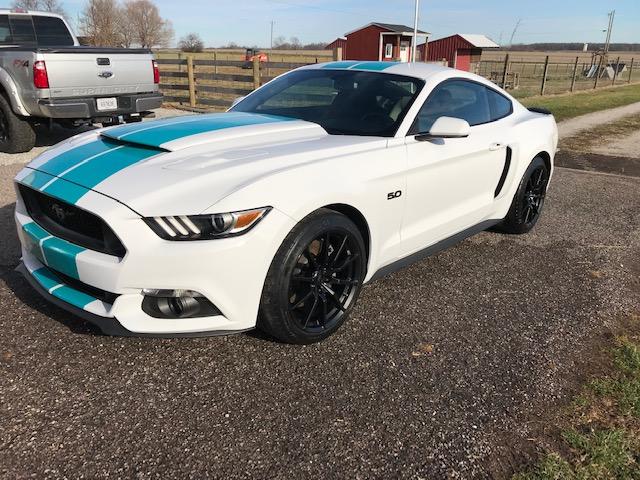

Good morning all, I am in a bit of a dilemma. I have a Ox WHT GT with the black accent package. The wheels are a thin 19x8.5. I like the black wheels but not the way they fit inside the wells. I found a good deal on OEMs GT350 wheels with Michelins so I bought them knowing I would have a little front poke. I really like the way the rears look. After much research I am confused how to reduce the poke without crushing the wallet. Lower with progressive, linear springs, coilovers, add plates, don't need them... I am looking for a more aggressive look and stance but don't go to the track. I can sell both sets and start over if that is what I have to do. Any recommendations are appreciated.

Poke will be reduced by getting a proper fitting wheel and tire. The OEM spec GT350 wheels are too wide to fit the fenders.
If you want to try to work with them, more camber but I'd say grab new wheels if you can.
Lowering in some fashion will reduce the wheel gap, not the poke.

The wheel gap doesn't bother me as much as how far inside the wheel well the original wheels were. I like the flush to the fender look much more. Then there is the issue of staggered or square. How do you get flush on the rear and front with square setup?

Mine aren't quite flush, but I have 20x10 with a +42 offset all around without any spacers, posted some all around pics here. You could run a small spacer in the front that way you can keep the square setup and maintain the aesthetic you're after.
