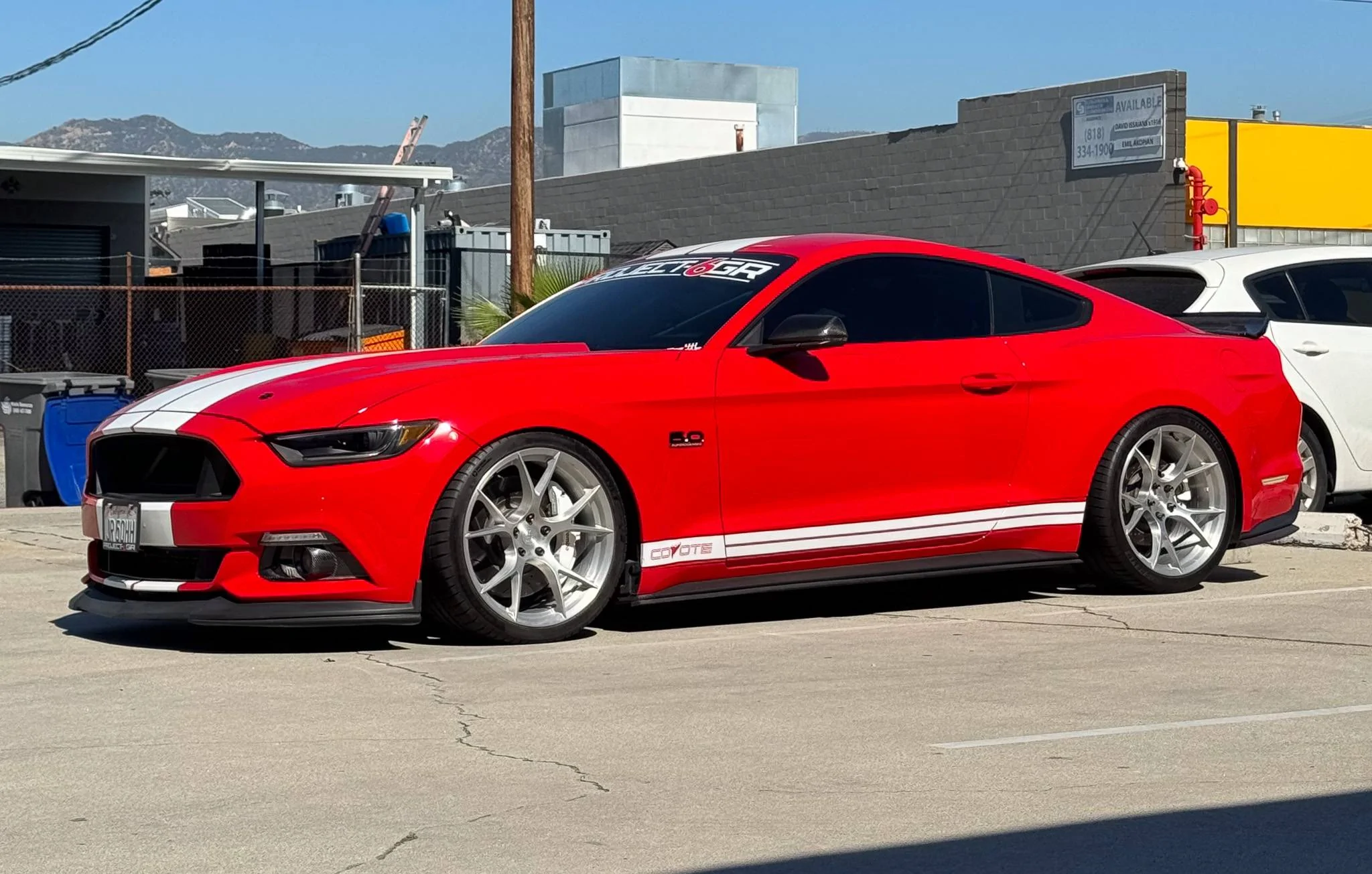

Hey this is Junior from N4SM, there are a couple of factors to take into account. Wheel offset, car height and alignment. Depending on how low the car is lowered on the coilovers and the offset of the wheels you typically shouldn't have a problem with the 20x9.5 with 275's all around. The alignment and amount of camber the vehicle has also will vary on how the wheels fit.
I run a 20x10 +35 285/30 up front and my car is lowered a little more than 2 inch's.
No issues with rubbing. Hope this helped. If you have any more questions reach out to us!
