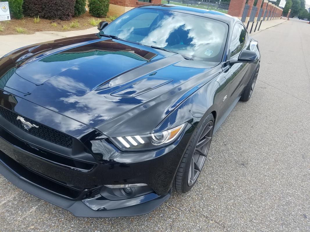

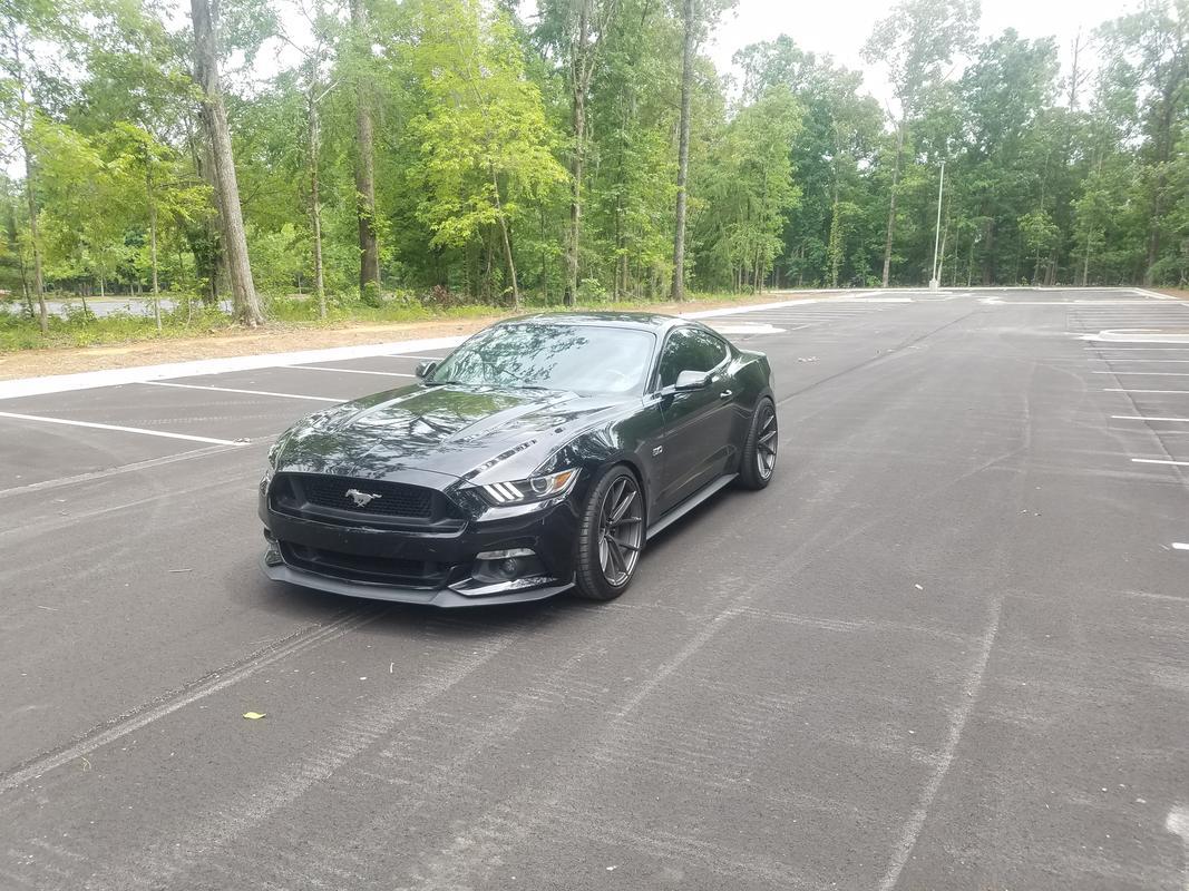

So I am confused....are you running 285 up front and 275 in the rear?
Yes. The rear sticks out but does not "poke." Its what you want.
Is that exactly what you have in the picture? Because I had someone with that setup tell me they stick out. Is it noticable?
No,, who does that? i guess the front is listed before the rear? Didnt know.

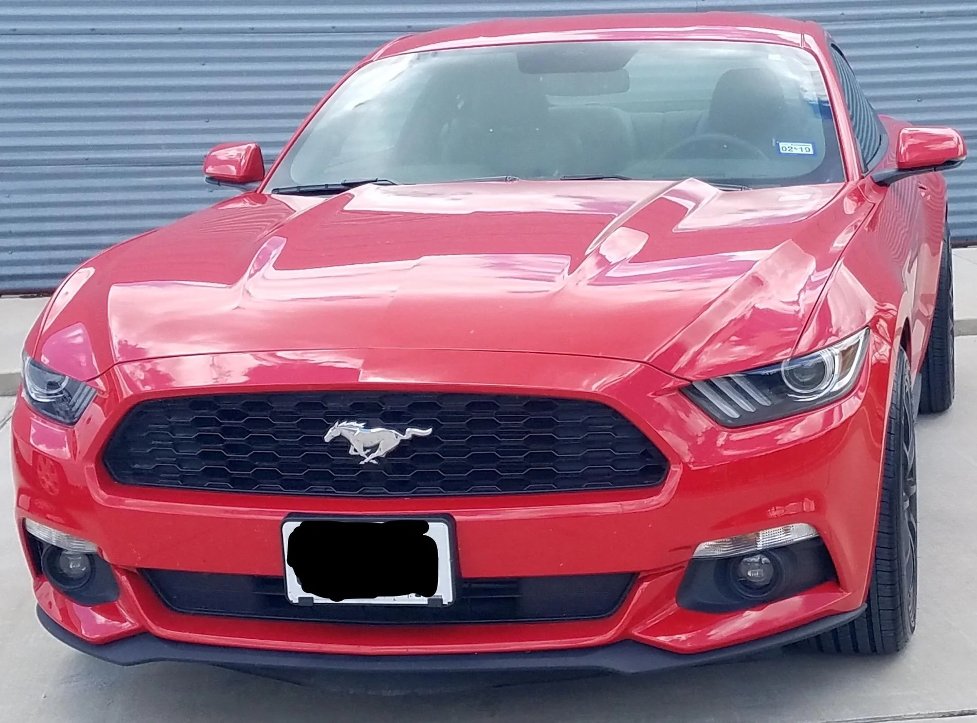

This is 20x10.5 et30 squared. I think I want 20" to close my wheel gap a little. That little bit of poke is worth it to close the gap a little since that's the only 20" offset option
You don't need a bigger wheel to close that gap. It's the diameter of the tire that makes the difference. It's more of a decision about whether to close the gap with more sidewall or more wheel.
How is the 275//285/30/20 ride quality?
