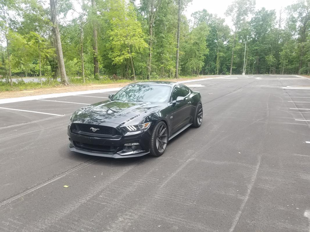

Of those choices I would go 19x9.5 et35 with 275/40/19 or 275/35/19 square.

20x10.5 +30. 285, 275
There..
Is that exactly what you have in the picture? Because I had someone with that setup tell me they stick out. Is it noticable?

This is 20x10.5 et30 squared. I think I want 20" to close my wheel gap a little. That little bit of poke is worth it to close the gap a little since that's the only 20" offset option
