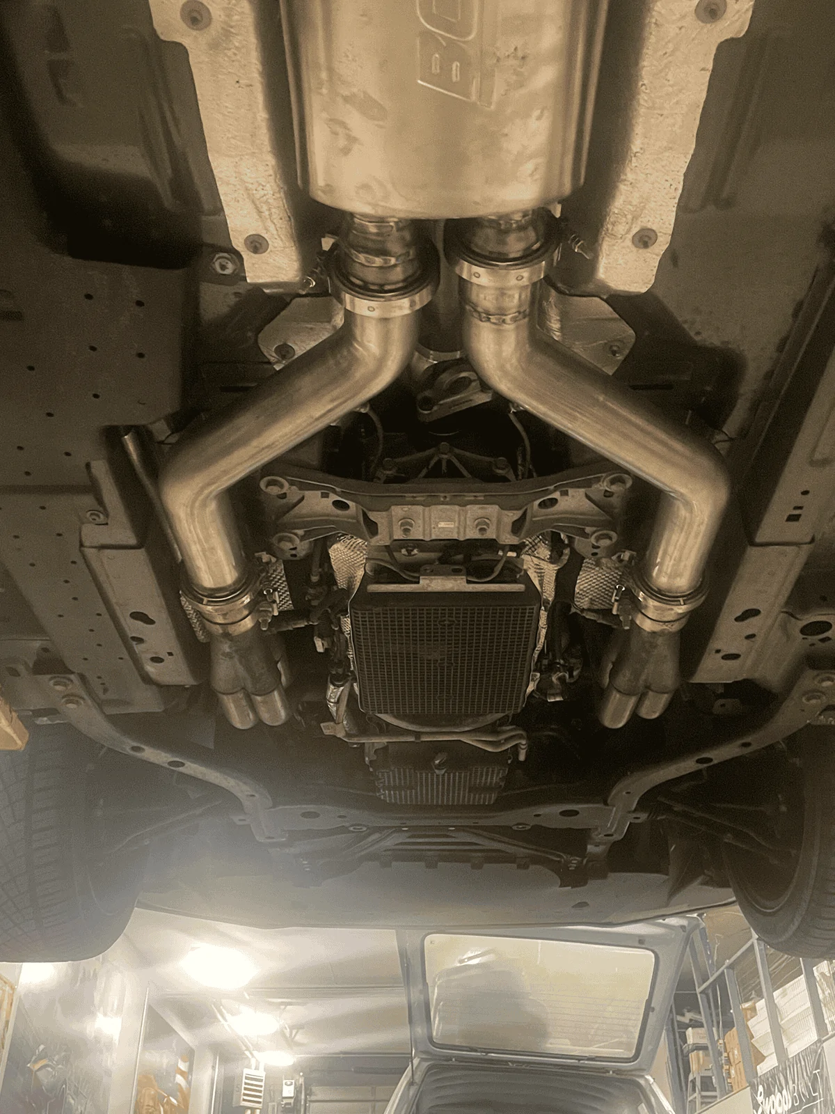

I have a 2023 Mustang GT. I just installed 2M fab Cat delete pipes to go along with my Borla S type cat back with X pipe. The car is loud and I’m looking too quiet it down a little bit. I wasn’t looking for Loud, but I needed to get the cats off Because the car is boosted. I am looking at the Borla resonator internal h pipe to quiet things down. Does anybody know if I will need any adapter to hook up to the cat delete pipes or not? I know it’s 3 inch outlet going to the cat back but 2 1/4 inch inlet going to cat delete pipes with are 3 inch. Just wondering if I’m going to have a problem connecting them. Any help would be appreciated. Thanks in advance.

you'll have to weld adapters on the front side if connecting to 3" pipes off the headers. I used 2.5'" to 3" adapters and v bands.

it’s not.. info on their site is misleading… rear connection is 3” but the front is made to connect to factory size something like 2.25”… I cut off the 2.25” section and was left with a 2.5” stub that I had the 2.5”-3” adapters welded onto…internally it’s 2.5”

One more quick question so the resonator internally is 2 1/2? So it’s the cat pipes are 3 inch going into a resonator that’s 2 1/2 inch then going into the cat back which is 3 inch correct? Thanks you for your help.

Yes.. it’s a bit of a restriction but where I’m at and looking to go it’s not a concern…

Yes, definitely a restriction, especially with me being boosted. My other alternative is switch out the cat back completely but I wouldn’t know which one to go with.
