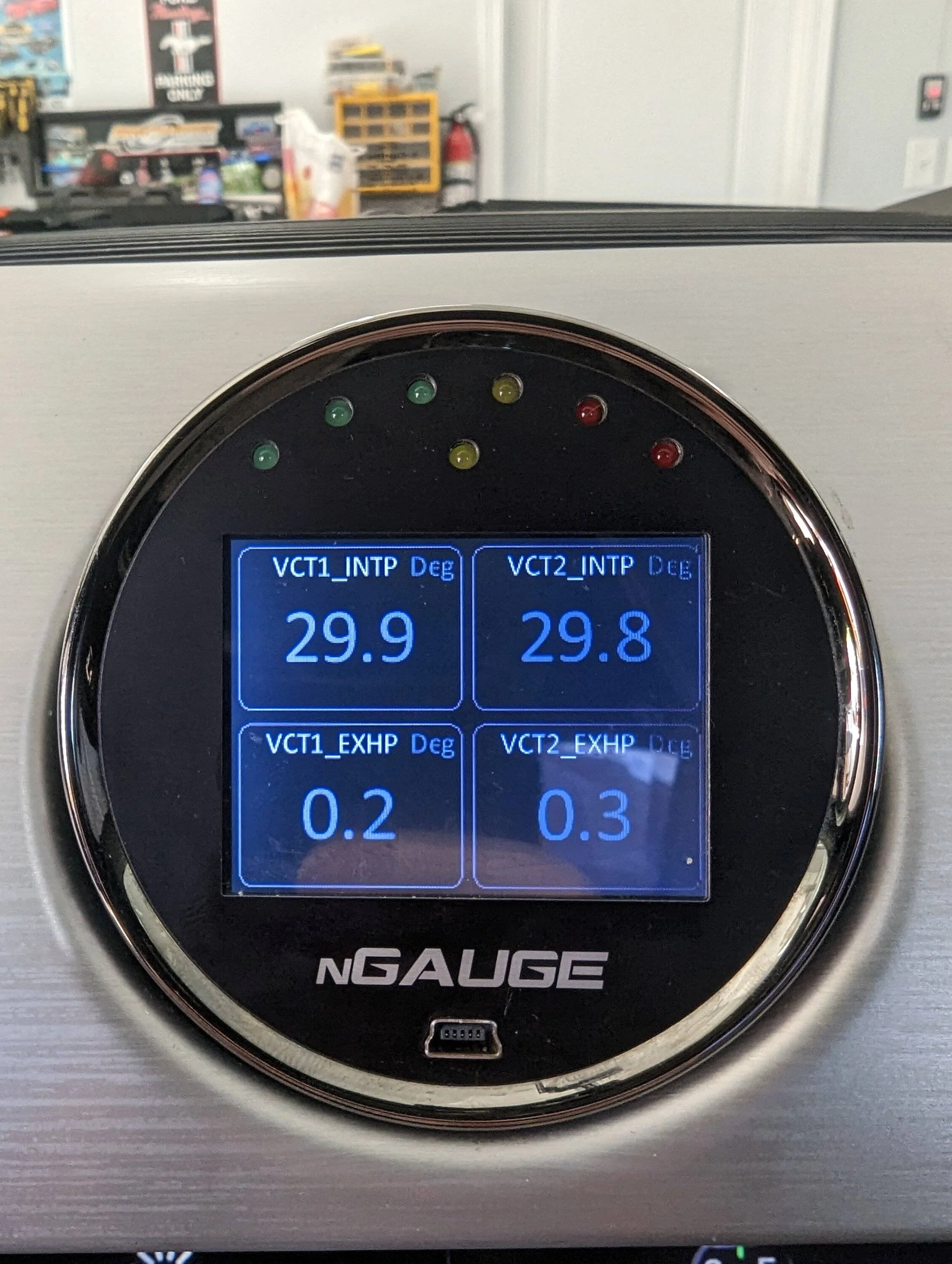

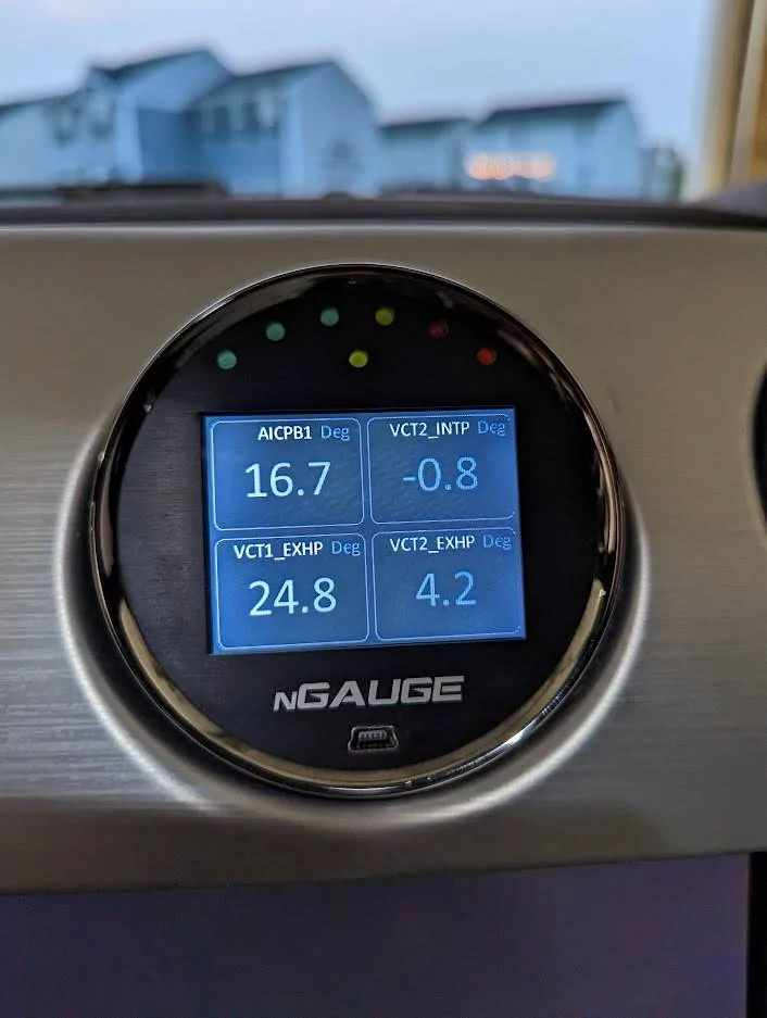

Long story short, it did fix the ticking noise, and it did start up right away after cranking it over, but within a minute the check engine light started flashing, and it was misfiring at idle. Checked the codes and had P0017: Crank/Cam Position Correlation, along with codes for random misfire on cylinders 2 and 4. I did try a crank relearn at that point, and cleared the codes, and the P0017 came back instantly. My next step was to check the VCT readings on my nGauge, and this is what they were:
(Left side top to bottom is intake and exhaust bank 1, and right top to bottom is intake and exhaust bank 2)
It was clear the timing was off, so I pulled it back apart and double checked myself with every step I could from videos and other guides people posted, along with the ford service manual (which at times is way less helpful than other peoples guides).

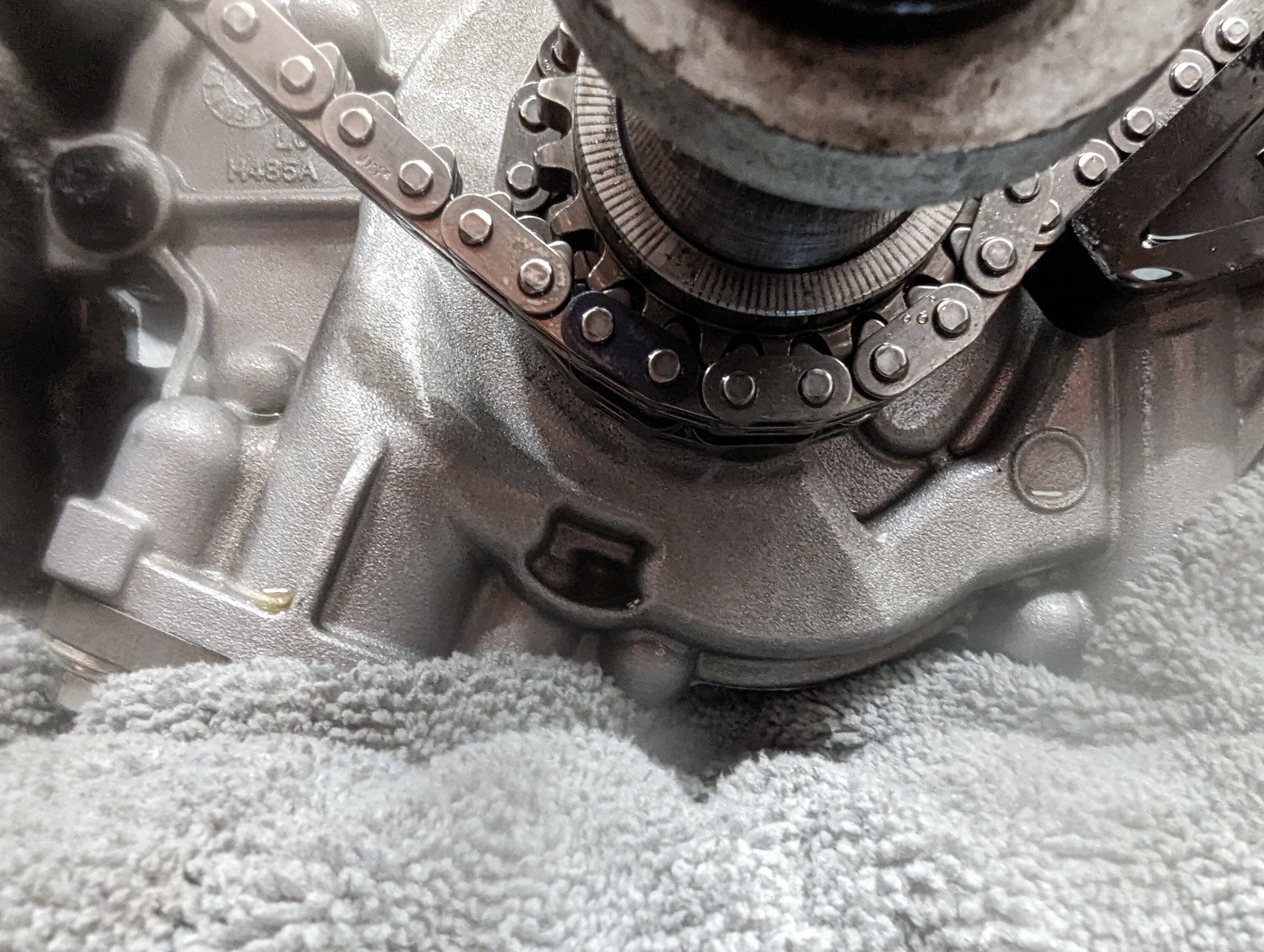

On the second attempt, I made sure I got the cams in the "neutral" position with the lines matching the images from the service manual / guides, and the secondary chains on the cam phasers as described. (Driver side intake phaser with the two black links facing up, and the exhaust with the one black link facing down, both on the timing marks, and the passenger side with the two links on the intake facing outward, and the one black link on the exhaust facing out), both sides slid on the cams in the slots without having to rotate anything very much at all, maybe a millimeter of adjustment while sliding the two phasers on. I matched the primary chain black links up as well, except the only questionable side was the passenger side after finishing driver side and spinning the crank 1 rotation,. and then back to the 12 o'clock position, it was almost impossible to get the lower guide / tensioner arm on without slightly moving the crankshaft clockwise, and then back (which the ford manual says you can do). Even after that it appeared the black links were on their respective marks.

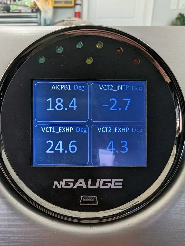

Same issue after this attempt too, and this is the numbers after this attempt as well:
The car did feel like it was driving "normal", and even went into boost like 1 or 2 psi with no issue, but obviously something is still wrong with those readings, and the P0017.
